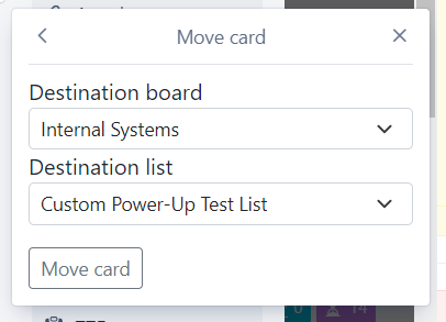

I am creating a custom Power-Up and want some things to be done automatically whenever a card is moved from one board to another. I created my own button at the back of a card called "Move Card" that I wanted to use to move the card and at the same time to make the additional changes that I had wanted to make. The only problem is that I can't figure out how to move a card.
