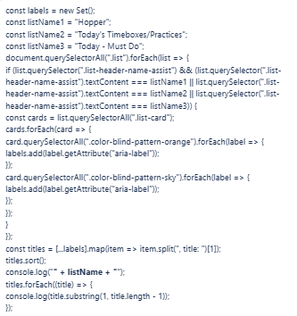

I would like to be able to get a unique list of all the labels that are used on the cards in a list or perhaps across several specified lists. I have some javascript that will do this but it is kind of clunky because I have to paste it into the Developer Tools console and run it from there. This is something I need to do every day.  Is there a cleaner way to do this?
Here is my use case:
Every day, I review cards across multiple lists on one board and move the cards I need to address in the current day to a single list for the day.  All off my cards have labels indicating the project they belong to or an activity label such as "email" or "phone."  Once I have the cards for the day moved to the list of todos for the day, I want to generate a unique list of the labels used on those cards so I can then go and schedule a timebox on my calendar for each label.  I then address the cards throughout the day according to the calendar timebox indicated by their labels. I've found that timeboxing my activities helps me get a lot more done.

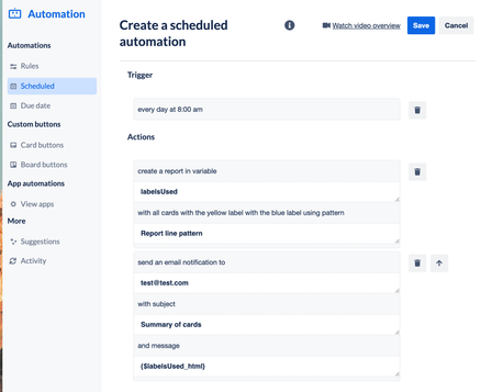

Another way to approach this would be to think about whether the information you need could be gathered using a Scheduled Automation, part of Trello's built in automation features.
For example, you could create something like:
"Everyday at 8am, create a report in variable 'labelsUsed', filter all cards that have the blue label and yellow label, and send an email notification to test@test.com with the cards in 'labelsUsed'.

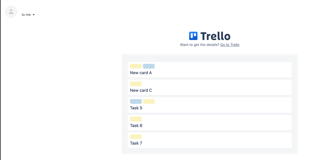

Example:
This would send an email through to the specified address with cards matching the filters you've set. You would likely need to adjust / tailor it to your specific needs, but this could help as a starting point to take the manual work out of it. :)

No worries! :) Based on your updated description, I tested a very simple example where I looked for all cards that had a yellow label assigned and generated an email report:
Here's how it looks in Automation:
You'll notice in this example I make use of the "using pattern". This allows you to draw upon Automation variables to choose how the information displays in the email report. You'll notice there are quite a lot of different fields you can use to format the report: https://support.atlassian.com/trello/docs/butler-variables/.

jhewgley
July 25, 2023
Thanks for continuing to help me find a solution. Your latest example makes good use of automation variables but it still doesn't produce a unique list of labels (label names). If there was a {listlabelnames} automation variable, I bet it would give me what I want. But there is no such automation variable (documented).
Essentially what I want is a unique list of label names that are used on a given list.
The icing on the cake would be able to get a unique list of label names used across one or more lists on a board (but not all lists on the board!).  The following JavaScript, when run from the console in the browser's developer tools, produces what I need across the 3 specified lists on my board. It is just very clunky to execute that way.  What would be amazing would be if Trello had the ability to save javascript snippets with a board and be able to execute with a custom list action. Since you can't do that (I don't think), I'm looking for another way to generate what I need.
