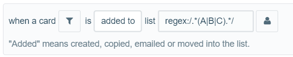

Ok, gotcha. Maybe try using one of the following:
Alternatively, you could use regex in your trigger to create an OR statement. E.g.
Using regex:/.*(A|B|C).*/ means that the trigger will apply when a card is added to lists A, B, or C.
