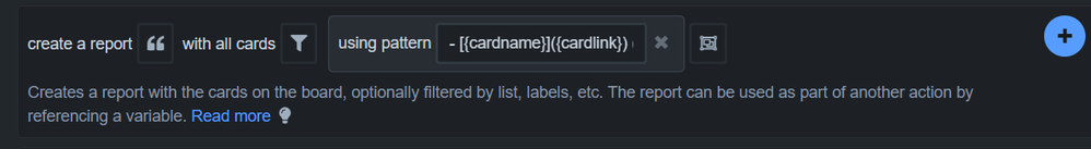

Hannah Humbert - Simpla Workflows
February 8, 2024
Oh strange! I'm not sure why that would happen 🤔 maybe there's a space in there somewhere? Have a look at this guide under "How to use a pattern to customize your report". It gives an example of formatting your report using bullet points. Maybe create a test and copy that exact text in the guide into the pattern field to see what happens. Here's the info below as well:
- [{cardname}]({cardlink}) ({cardmemberusernames}) {{%Priority}}
It should look like this in butler:
