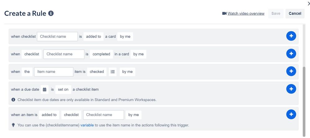

Step 1: Determine the Trigger
Your trigger might be as the 4th:Снимок экрана 2024-02-22 151110.jpg

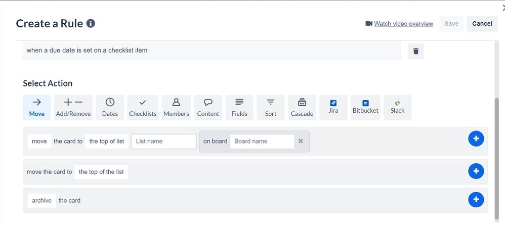

Step 2: Configure the Rule in the "Doing" Board
Apply the first rule:Снимок экрана 2024-02-22 151234.jpg

Thanks for your time in getting back to me Maria, but I am completely lost. Managed to get at least the checklist item creating a task in the doing board. Haven't figured out how to get the due date to come across, or how to close the loop with the checklist completion. But this will have to do for now.
