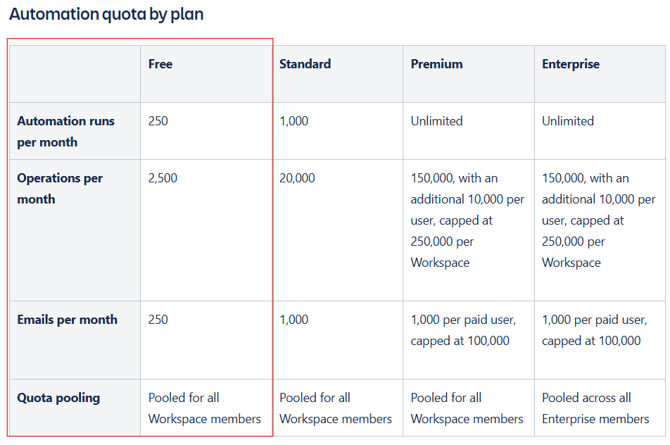

Nadine Sharma-Galarza
February 12, 2025
also - what is my maximum automation runs for the month?   On the Free version of Trello?
DiMaggio Tucci
February 12, 2025
@Nadine Sharma-Galarza Here you go:
https://support.atlassian.com/trello/docs/butler-quotas-and-limits/
Automation runs and operations
Automation run: Every time an automation button is pressed, or an automation is triggered, it counts as one automation run.
Operation: Every action taken by an automation counts as at least one operation.
Each automation run may use more than one operation. For example, an automation may set a label and a due date on a card. This counts as two operations every time it runs. Most actions consume one operation, but some actions, like sorting a list, may require multiple operations.
