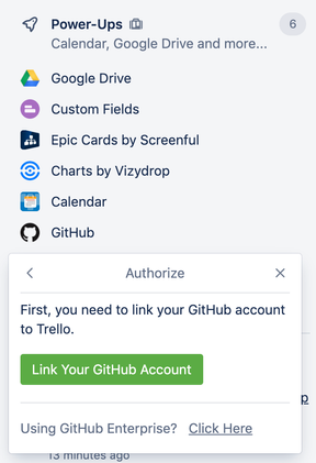

1) I select "Authorize Account"
2) I click on "Link Your Github Account"

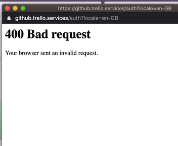

3) Then a new window pops up and I see this:

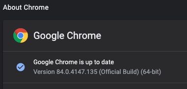

I'm using Chrome version:

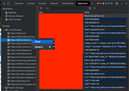

If none of those worked, could you try clearing your localstorage for the "github.trello.services" domain? I've attached a screenshot of where you can find that on Chrome (should be similar for other browsers though).

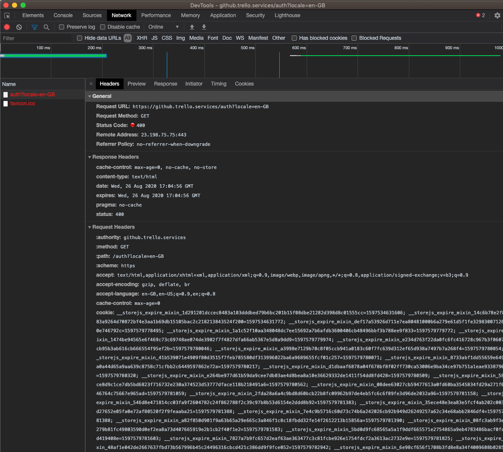

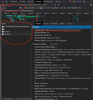

When you do encounter these errors, could you try having the network tab open when they happen? Filter down to only ones related to github. Failed requests will have red names. If you could, take a screenshot of the "Headers" and "Preview" tabs of the failed requests.

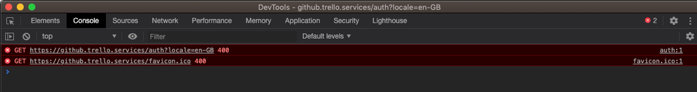

And finally, any console logs relating to the failures would be appreciated too.
I have tried the above and it does not seem to fix it.
Here is the screenshots you wanted:

Thanks for those screenshots. While I am still investigating the issue, I do have a theory.
It's possible to receive a 400 error from a server if the cookies in the request header are too large. And judging from the screenshot you provided, it's possible that this is happening.
Could you try deleting all cookies on your browser from the "github.trello.services" domain, then trying to re-auth Github again? If you're on Chrome, you can do that by going to "chrome://settings/cookies/detail?site=github.trello.services" and pressing "Remove All".
And if that doesn't work, you can try removing all cookies from all domains on your browser, then trying to auth again.

Awesome! That worked like a charm! Thx!
