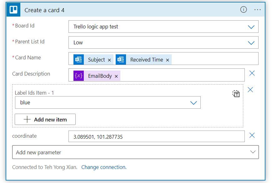

Hi, how do i can get the location that have in trello by using azure logic apps to input the coordinate/address? and it will be display in trello card.
bellow is something that i trying to work on.

@Teh Yong Xian
The coordinate looks like SIngapore. :)
With the premium plan, the map should be automatic show on the back of the cards if you update the address, coordinate correctly.

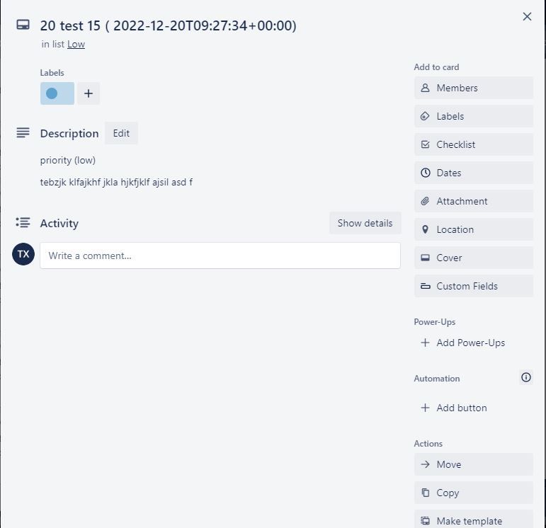

Teh Yong Xian December 20, 2022
@milynnus this is the result i just test,
It not auto show the location when this card is created.
milynnus
December 20, 2022
@Teh Yong Xian
add .json to the card url on your browser. If the azure app is working correctly it must  create something similar to this
{"id":"62e05....607ff1","address":"80 Mandai Lake Rd, Singapore 729826","badges":{"attachmentsByType":{"trello":{"board":0,"card":0}},"location":true,"votes":0,"viewingMemberVoted":false,"subscribed":false,"fogbugz":"","checkItems":0,"checkItemsChecked":0,"checkItemsEarliestDue":null,"comments":0,"attachments":1,"description":true,"due":null,"dueComplete":false,"start":null},"checkItemStates":[],"closed":false,"coordinates":{"latitude":1.4043485,"longitude":103.793023},
It it does the map will not show. You have to approach the app provider. You can use API to set this parameters and the map will show. Sometimes you have to refresh the page.
alright, will have a try on this, will update u later. Thank you again
the solution is work, i just need to add "location":true,", "coordinates":{"latitude":1.4043485,"longitude":103.793023},
it will as what i trying to do.
