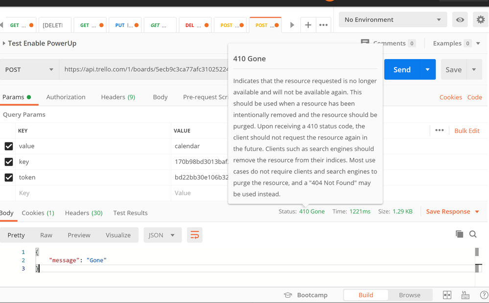

So, I tried to enable power up with below API.
https://api.trello.com/1/boards/{boardId}/powerUps?value=customFields&Key={Key}&token={token}
Now I key "invalid key" error. 410 unauthorized error. I am passing key and token in query param. And for all API like board create, card, list everything works fine. But for it doesn't work for power up enable through API. Any suggestion?

So, trying with pluginId with this URL
https://api.trello.com/1/boards/{boardId}/boardPlugins?idPlugin={customFieldId}&key={Key}&token={token}. Getting "The requested resource was not found." Seems something is missing my end.

Gaurav Srivastava
May 25, 2020
You are 100% correct. I gave wrong boardId. My bad. Appreciate your help. :)

Iain Dooley
July 13, 2021
@Wouter actually the ability to enable power ups through the API was removed recently so if you try you will get an authorisation error.
