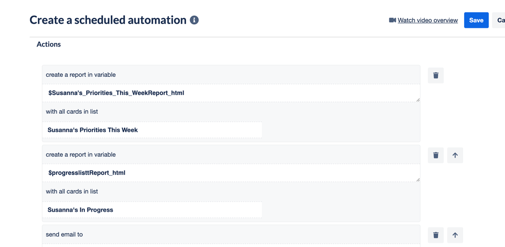

I need to create 2 emailed reports that includes items from 2 lists in one case (daily) and 4 lists in another (weekly). I have tried the advice in response to another question, but it's not working for me.
I do get a report if there is only one list in the automation, and I can get a multi-list report if I choose all items assigned to me, but I don't want to use the "all assigned" method for the daily email because I don't want "done" items on the list. On the weekly email, I could do the snapshot but I don't want the "done" list included.
Thanks for any help!

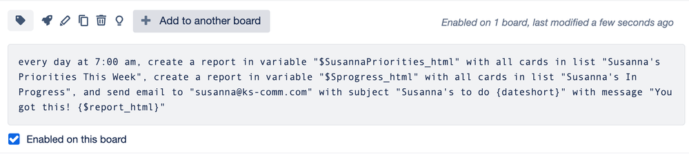

Here's the code I have, showing two different formats I tried -- neither of which worked.

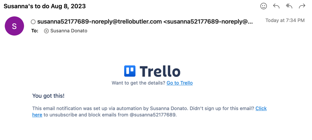

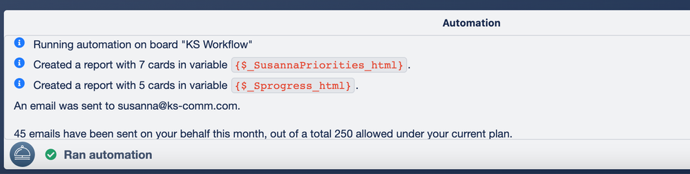

Thank you! I did look at that guide, but maybe the piece I am missing is how to create the variables. I re-wrote my variables without special characters or spaces and then again with the _html that I saw referenced in another similar question. The automation report says it pulled 7 cards in one list and 5 cards in another list, but I still get an empty email with either format.
Where am I going wrong now? Appreciate the help!

When creating an automation report, you'll first need to create the report variables with plain text.
Then send a visual email and include each of report variables you've created {$reportvariable_html}
Based on the automation you've set up so far, you'll want to make changes to the email message, so it can look something like below:
every day at 7:00 am,
create a report in variable "susannapriorities"
with all cards in list “Priorities This Week”,
create a report in variable “Sprogress”
with all cards in list “Susanna’s In Progress”,
and send email to “email address”
with subject “Susanna’s to do {dateshort}"
with message “You got this!
Priorities this week: {$susannapriorities_html}
Susanna’s In Progress: {$Sprogress_html}"
I hope that helps!
