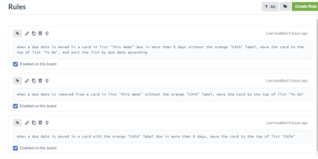

Can't seem to get a couple of my automations working in Trello PC web.   Attached a screen cap.  The two rules below aren't working, or are inconsistently working.
  • when a due date is moved in a card in list "This Week" due in more than 6 days without the orange "CATA" label, move the card to the top of list "To Do", and sort the list by due date ascending
  • when a due date is moved in a card with the orange "CATA" label due in more than 6 days, move the card to the top of list "CATA"
In both cases, when I change an existing due date from today to 7 or more days in the future, the card does not move to the appropriate list.  Seems like a trigger issue as sometimes when I play around with the due dates the rule will work, but seems to be no pattern to it.2021-06-18 16_16_00-To Do _ Trello.png

Hi Jordan,
Thanks for reaching out about this. This rule is currently filtering based on the trigger condition. Therefore it will only trigger if a) the card is in the "This week" list and b) if the due date on the card before the change was more than 6 days away. If you are changing the due date from today, then it doesn't fit the filter.
It sounds like you want to detect what the new date is and trigger the rule based on this. Here is where you can set this: https://share.getcloudapp.com/NQuoYwkO
Could you try that and see if it works for you?
Thanks,
Ryan
