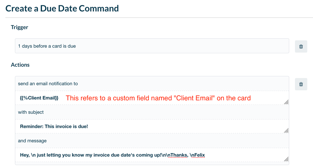

You could do this with Butler, Trello's automation tool.
It does require a paid Trello subscription (sending email in Butler is only available on the paid plans). Here's an example of a due date rule that could do what you're asking:

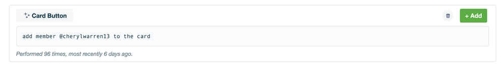

Thanks a lot. I have set that up but doesn't seem easy enough to add to all cards? Also, where is the automation tool grabbing the clients email from?
Its easy "add" other prompts like this - Screenshot 2020-08-07 at 15.36.01.png
But the prompt I'm looking for shows this -
Screenshot 2020-08-07 at 15.35.37.pngThanks in advance.

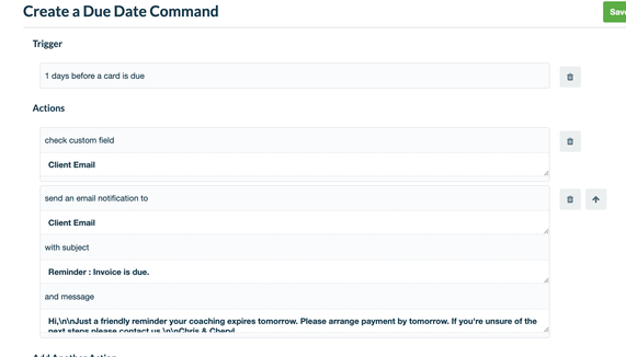

Created the custom fields. Would I have to add any coding?
Is this ok?

Vongsawat
August 8, 2020
Remove the Check custom field command. That's for checking a checkbox.
Client Email needs to be written as {{%Client Email}}, that's how you refer to the data in a custom field (which in this case has to be called Client Email exactly)

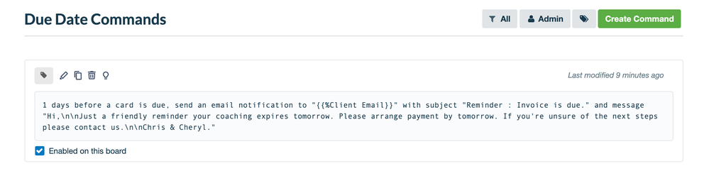

Chris Bradley
August 10, 2020
Hi Iain,
Thanks a lot for the support on this.
Made the changes you suggested and still can't seem to get it to work despite doing a trial run of setting up a due date to tomorrow with my email and still I don't seem to get the email.
