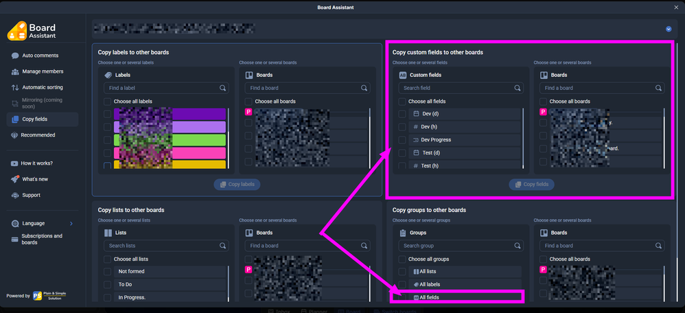

Hi Martin!
To sync custom fields across boards, try the Board Assistant Power-Up. It has a "Copy custom fields to other boards" feature that lets you select specific fields and copy them to multiple boards at once — which should solve your alignment issue.
https://trello.com/power-ups/685016dd47b5654ae385bba6
