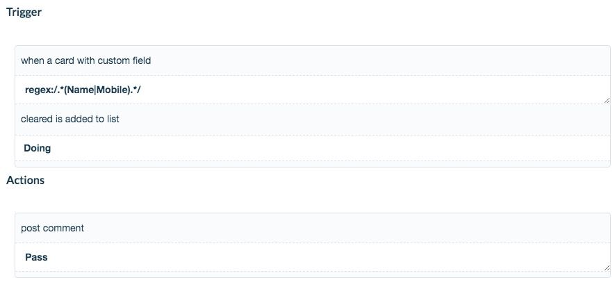

This seems to work for me. Comment is post when (1) either is cleared or (2) both are cleared. Both name and mobile CF are text fields in my test case.
when a card with custom field "regex:/.*(Name|Mobile).*/" cleared is added to list "Doing", post comment "Pass"

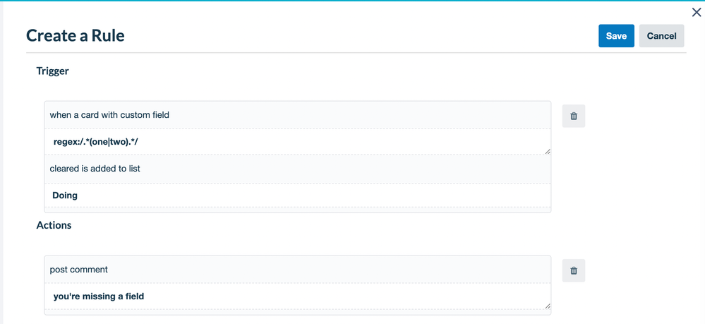

@Massimiliano Traversari yeah Trello definitely does get tricky when there's ORs - i also agree that would be a great feature.
Sometimes @milynnus can help me come up with OR workarounds using regex, though, and i actually think Custom Fields could be one... something like this
But that doesn't seem to work. @milynnus any ideas?

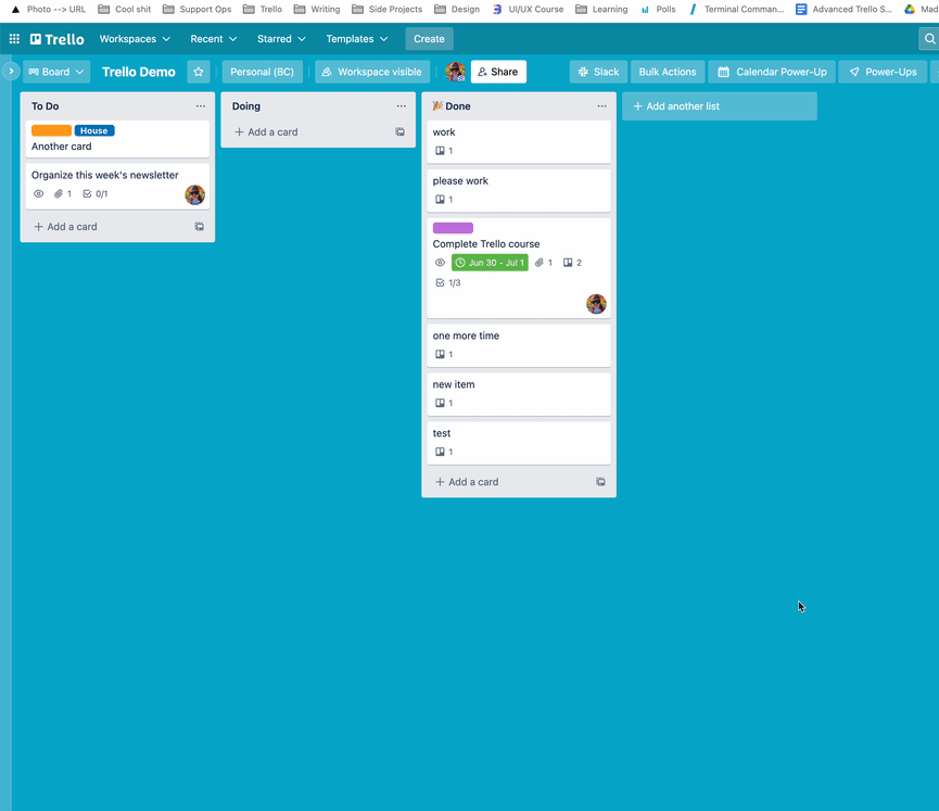

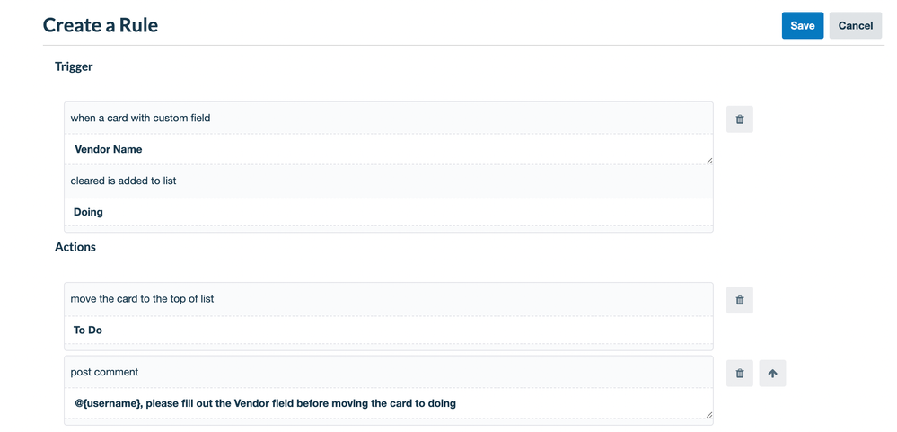

The best I have been able to find with native Trello custom fields and "mandatory" is some automation. For instance, if you want to require a field to be filled out before a card is moved to a specific list, you could create a rule that says if a card moves into x list and the y custom field is blank/cleared, move the card back to the list and create a comment that tags the user who triggered the action to update that field before moving the card.
Something like this:
Here it is in action:
I actually might make a video of this, cause I know it's not perfect, but hopefully a decent workaround.

@Brittany Joiner I tried @milynnus rule config on 3 custom fields in my board, but I had some strange issues too. Sometimes it worked, sometimes not.
I made three fields: location, colour, number_of_people
milynnus code worked in these cases:
  • all fields empty
  • colour field set only
  • number_of_people set only
  • colour and number_of_people set
but it didn't work in these:
  • location set only - in this case the card was not moved back to To Do
I thought it could be caused by the "custom field cleared", as milynnus stated in a comment. So I changed my rule config to:
and now it's working fine for me, doing the job.
@milynnus still I can't understand why your config works for you and not for me, but your advice put me on the right way. Thanks

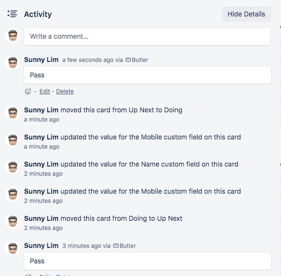

The log showing the change to the CF and the subsequent write to comment. What I am noticing the long delay...the Pass was a few seconds, the move was 1 minute ago

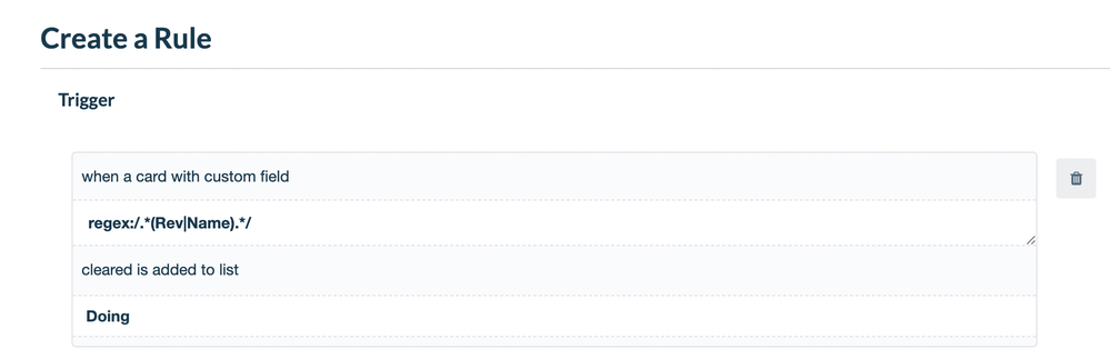

@milynnus ah wondering what i was doing wrong with it on my end! you know, i renamed the fields to make them shorter and easier to put in regex and i wonder if there was some race condition where Butler didn't realize the new names.
so yeah @Massimiliano Traversari that should work then!! will be one long block but you could do that in one rule!
