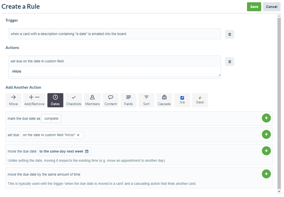

Hi @Esme Crutchley !
I've the same problem, but i don't have the same options...
I need fill the due date with the time and hour of e-mail description.
Example:
E-mail subject:
New installation for Fred Guimarães
E-mail description:
2020-10-29 14:00
Screenshots attacheds.

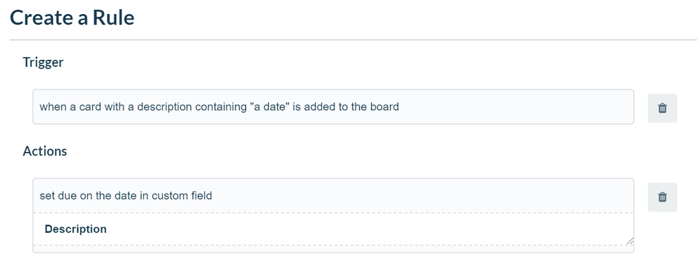

Hi  @Mattias Vd
Thank you for that! The first problem that I can see is that, yes, you're right, it's looking for text "a date" - if you change it to {a date} it might work. Because it's looking for that specific information, you want to add curly brackets to indicate that it's not a specific thing that you're asking it to find.

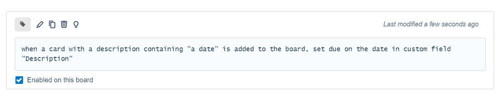

Thanks for your reply. Here's a screenshot.trellorule1.pngtrellorule2.pngI guess it doesn't realise in the trigger that I'm looking for a date, it just looks for the words "a date".
And in the actions, it goes completely wrong. I tried putting an action "set due date on next Monday". That works (when I mention "a date" in the description). But I want it to take the date from the description itself, whatever that date is.
