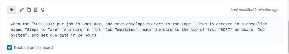

I can't seem to get this to work...any help appreciated.
Basically, once a specific item in a checklist is ticked, I would like that to trigger moving the entire card that includes that checklist to the top of another list on the same board. I would additionally like to add a due date to that card for 24 hours into the future.
Even if I strip down my command, I can't seem to get the trigger to cause anything to happen...much less the two actions I am hoping for.
Here is what I have so far:
Again, any workarounds, tips, or tricks are much appreciated!

@Babs Noelle that command looks correct, have you tried with differently named items/list etc.? Like for example can you create a checklist item called "test" and trigger like:
when the "test" item is checked post comment "checked"
and start from something that simple and build it up?
Also check the Usage Log for errors:
https://help.trello.com/article/1150-opening-the-butler-usage-log

On a whim, before erasing everything I had written, I changed the name of the checklist item in question…by simply replacing the colon with an equals sign.
Done!
