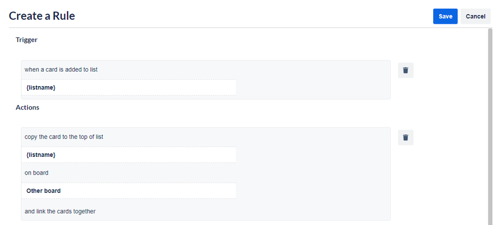

Instead of copying the entire list, could you actually have an automation that copies and links the card when it is added to the list.  It would look like:
Jesse
April 20, 2023
Unfortunately that would trigger off other rules. I have another weekly process that updates a subset of the cards. This would create out of order duplicates on the other board.
