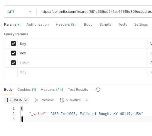

Thank you for your reply. Do you know if it's possible to achieve this using Butler? I tried the following:
put to URL:
https://api.trello.com/1/cards/{cardid}/customField/680766d760c2f606fd47a8d3/item?key={api_key}&token={token}" with payload "{\"value\":{\"text\":\"{{cardlocation}}"}}
But getting a null response. Maybe {{cardlocation}} is the wrong variable?
P.s. I am not a dev, so this is a bit over my head.

I can see "locationName" but it doesn't seem to work. This is what I'm inputting into the payload:
{"value":{"text":"{{locationName}}"}}
I'm using a card button to trigger the action, and it's not throwing any errors when triggering the button; it says it has run successfully, but it's not returning anything in the custom field. If I hard code it to {"value":{"text":"Test Location"}} that works fine, so I know it's the variable that's not working.

@Hannah Humbert
If you are using http request,  {httpresponse} variable if the api executes correctly.
https://api.trello.com/1/cards/681c559.....5d309e/address?key=9e3.....e98&token=ATTA1...
Based on the the variable would be {httpresponse._value}. You need test it out on your actual automation as this is just using POSTMAN
