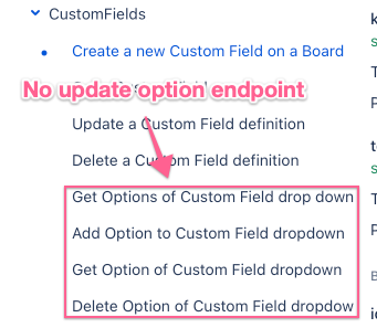

It's a little slower than selecting from a dropdown, but dropdowns are kind of a non-scalable solution, they can become cumbersome to select for large numbers of options, and to my knowledge there is no way to re-order dropdown options even with the API, there is no update dropdown option endpoint, only add, fetch and delete:
If you were to delete all the options and re-add the same options in alphabetical order, all the cards which already had values selected would lose that information, so you'd have to build an array of card/option values, then rebuild the options, then select the appropriate option. It would be super messy.
You can create the same custom fields easily enough on a bunch of different boards from a template, but again synching them is problematic because of the ordering problem. IMHO you're better off using checklists for this sort of multiple choice. You can reorder them and it's easier to keep them in synch across multiple boards.
