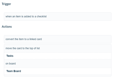

Is it possible to set up a rule in Butler to convert a checklist item assigned to a member into a new card on another board? I'm new to using Butler and I'm not sure how to even attempt this.
Thanks for any assistance!
Hannah Humbert - Simpla Workflows
March 29, 2022
Hi @Sharon Blanchard ! Welcome to the community :) Yes! This is possible. Your rule would look something like this:
The trigger is pretty broad, so you might want to narrow down which items need to be turned into linked cards and sent to this specific board. You can make your trigger conditional - e.g. "when an item containing "X" is added to "X" checklist".
Let me know if you need more info :)

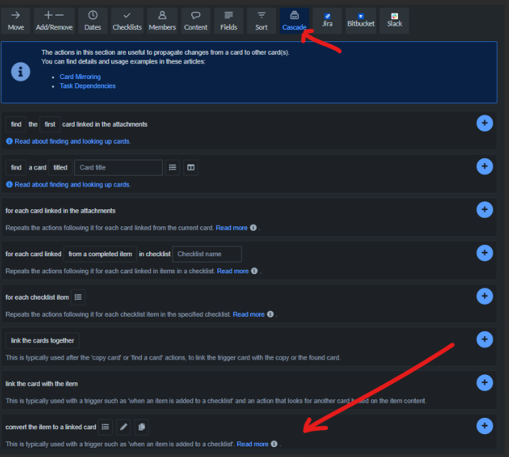

This is the exact solution I am looking for, however, I don't see the 'Convert item to a linked card' as an option when building out the rule.  Could this have been removed from the functionality recently?  Is it still available?
November 29, 2023
@Nicole Pennington I missed your message, sorry! Hopefully, you managed to find it! But if you didn't, or if anyone else looks at this, this is where you go to find the action to "convert item to a linked card":
