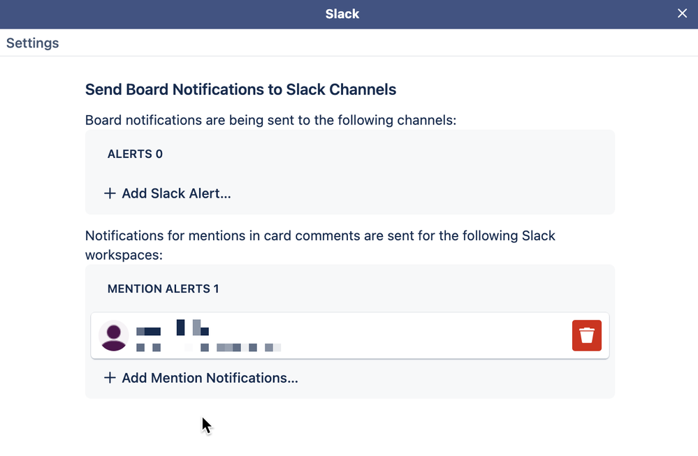

It sounds like you're on the right track - have you added a Mention notification in the Slack settings for your particular board yet?
If not, that may be the missing piece. To check:
  1. Open the board where you want to receive Slack notifications from
  2. Click Slack at the top of the board
  3. Click Add mention notifications
If you already see your name listed there, try removing the mention notification and adding it back just to be sure it's not stuck somehow.
Last - only mentions in comments will send a notification to Slack. Mentions in a card description will not, just a heads-up!

The first would the list general Slack notifications. These are configured in the same place as mention notifications, but you would click the Add Slack alert button instead. These are sent to a Slack channel of your choice.
