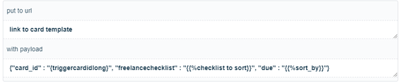

Thank you so much! Does this mean I would add an additional action to each automation rule with the below criteria? I'm not very familiar with code unfortunately so I'm not sure if I'm doing this correctly.
I replaced "checklist_name" with the name of my checklist and replaced "sort" with due

The module is called via the http request. Depending on your actual setup, yes it can be called within a command or as a card button.

This is how it looks like using a card button...card id, checklist name and sort option are hardcoded but you can use card variables {} and {{%..}} for more flexible deployment.
