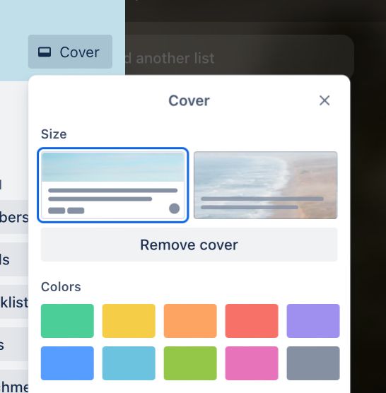

I guess what your are seeing is the two different style of "Covers" as they are called on Trello cards. If you go to your card and press the Cover option Button (top right) you see that there are two options
The one on the left (Normal style) is the one you desire, so switch to that on the cards that do not look right to you...

Rasmus you are a star!! Thank you so much, I am a newbie and for the life of me I couldn't work it out, but this is perfect. thank you so very much!
