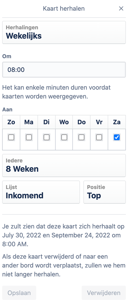

I have been having issues with the Card Repeater power-up. I make a new card on my board where the Card Repeater power-up is active, and I try to set up a repeat. I put in all the details (such as the interval and the correct list to repeat in) and then I click save.
Both the save button and the delete button then grey out, as if it's in the middle of saving / deleting. But nothing happens after that, not even when I wait a full minute.
It's supposed to automatically close the window and have set the repeat up. Sometimes it DOES magically save for whatever reason. Can anyone please help me?
Thank you!
P.S. Below is what I see. Please note that it's in Dutch: 'Opslaan' means 'Save' and 'Verwijderen' means 'Delete'

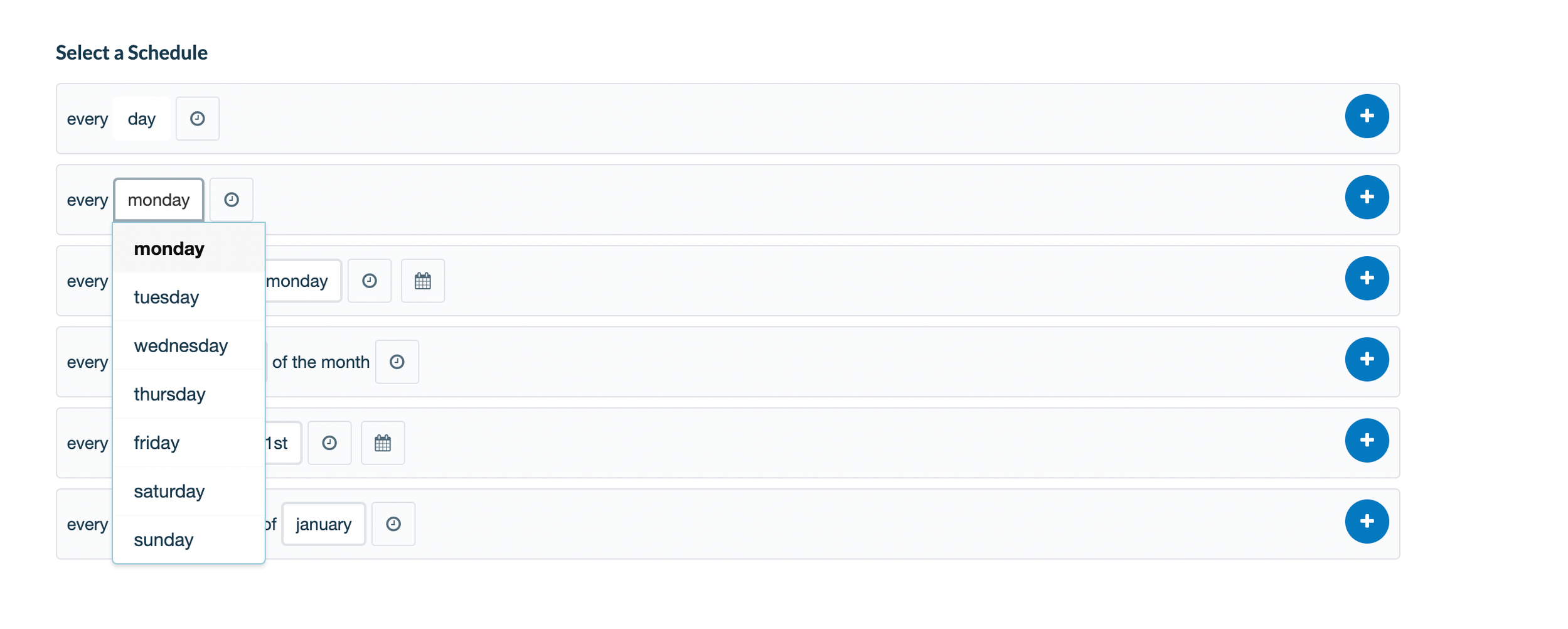

You can use Butler/Trello automation for repeating cards. If you want to do card repeating in Butler, just head to Automation (top menu of your board) --> Rules --> Calendar (on the left side menu) --> Create Command (blue button in the top right).
From there, set your trigger, by clicking "add trigger". This is the frequency you want the card to show up (every day? every work day? every Wednesday?)
Click the blue plus button to add it, and then select the Add Card option. You can specify which list you want it to be created in, any checklists dates, or labels you want it to have, etc.

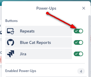

It happens to us also, time after time. Randomly. What I tried (and it worked) is to open the "Power-Ups" menu (top-right section of the board), disable Repeats power-up, and then enable it again.
Just a bit of pure luck or workaround, I don't know...
