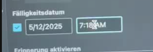

Julia Trippo
May 12, 2025
Yes, I took a video, I hope it shows the problems I am facing:
https://www.dropbox.com/scl/fi/hhftcwrhp11mibtws6ymk/Trello-Date-fail.mp4?rlkey=i2el90agzz7k1rdge1oe2b4mt&st=arnz3fxw&dl=0
Language is German, yes

@Julia Trippo Hi Julia. I'm still having trouble recreating this internally.  But I did just notice something in your video that's different from what it should be.  For the German locale, the time format should be 24-hour time, rather than 12-hour time with AM/PM.  For example, here's a screenshot of a testing board with the German locale turned on, and you can see that formatting is 24-hour time.
But in your video, the format is in 12-hour time.
I also noticed that the date on the card back isn't formatting correctly either
This is what the German locale date / time format should look like
So, something is going on where Trello is not getting the appropriate locale from your browser in certain cases.  You mentioned that you selected German as the language in your Atlassian settings.  Is there a possibility that your browser's language settings are different?  Or possibly some extension that's changing the formatting of dates?  Also, what browser are you using?

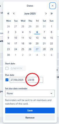

Dr Dave Wyatt
June 6, 2025
Thanks for your comment Michael. I have just checked and I now seem to be able to change it both in Firefox and Chrome. What was happening is that when I wanted to change the time (marked in red circle) this was in AM/PM format and when I changed it it kept reverting back to the time I created the card. As I say this now seems to work.
Could this have been an old setting associated with my account which has now correctly synced to my current setting?
