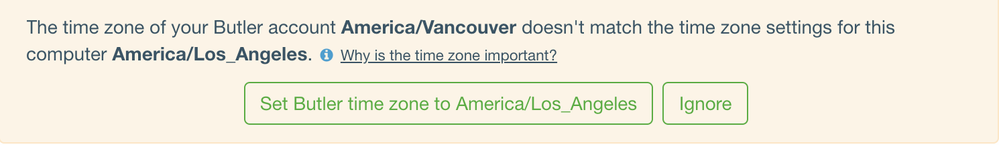

Screen Shot 2019-05-20 at 8.34.46 AM.pngScreen Shot 2019-05-20 at 8.34.33 AM.pngI have attached a screenshot of the type of command that won't run as well as the error message I am receiving. Thanks!

I think you need to press one of the two green buttons before the command can run, Danica.
"Ignore" keeps it at America/Vancouver, the other one sets it to America/LA.

I'll try the ignore button. I clicked the other button initially, which is what started the commands not running. Because all my devices are set to my home timezone, I've been getting this error message on other devices as well.
