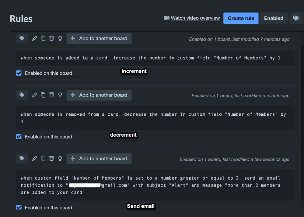

This is definitely doable and to achieve it you will have to add 3 automations and 1 custom field.
Custom field
You will need to add a number type custom field to keep track of #members in the card
Automations
Increment
You will need to use an automation to be triggered when someone is added to the card and then increment the customfield created in the previous step by 1
Decrement
You will need to use an automation to be triggered when someone is removed from the card and then decrement the customfield created in the previous step by 1
Email
You will need to use an automation to be triggered when your customfield is more or equal to 5
