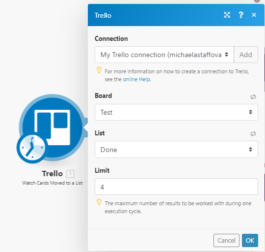

1) Choose the ‘Watch Cards Moved to a List’ Trello module. Within the module, connect your Trello account to Integromat (there’s a link to the support documentation in case you need it). Select the Board you want to watch and the list to which the cards will be moved (in this case: Done). Set the maximum number of processed results within one run (in this case I chose 4 because you said there are 4 employees involved).

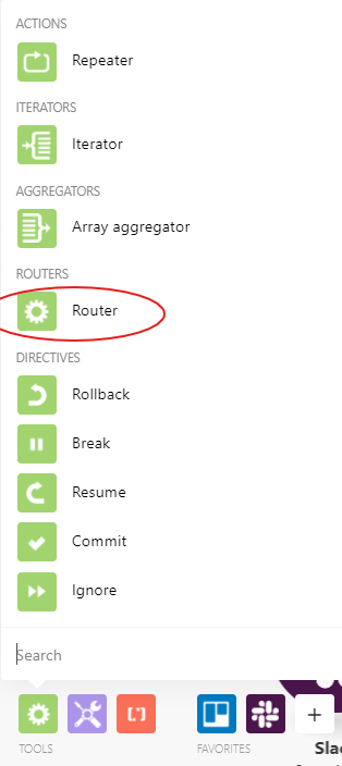

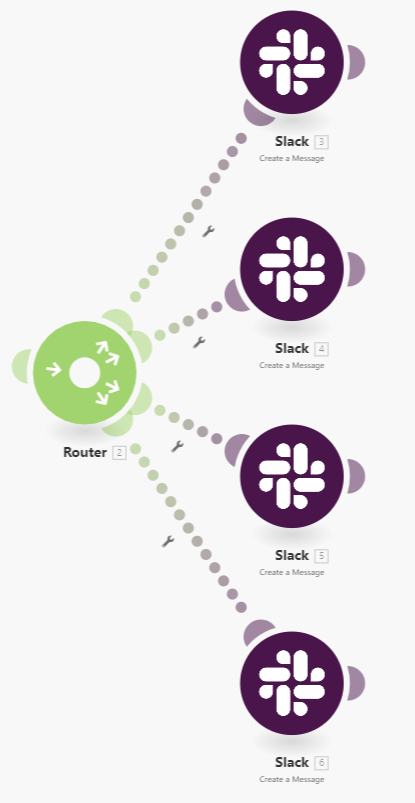

2) Add a router from the ‘tools’ section at the bottom of the builder

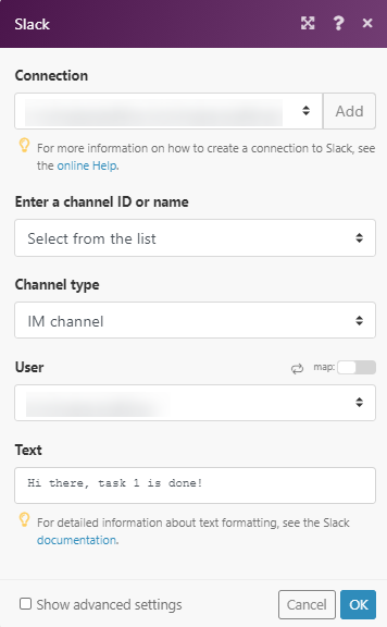

3) Connect four ‘Create a Message’ Slack modules to the router.

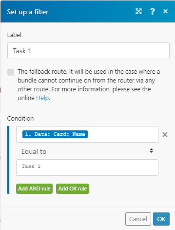

4) To make sure that the right person receives the right message at the right time, we need to set up corresponding filters. To do that, click the wrench symbol on the dotted line between the router tool and each Slack module. The condition we want to set here is that if the card that’s been moved to ‘Done’ is called ‘Task 1’, a Slack message notifying the second person in line is sent. Of course, it's necessary to set the filter for each card/Slack message.
5) Set each Slack modules to send the notification to the relevant person. Create a connection to your Slack account. Select the type of channel where the notification will be sent (public channel, private channel, IM channel). In this case, I chose a private message and therefore Integromat let me select the user I want to send the message to. Finally, enter the body of the Slack message.

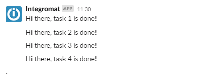

6) Run the scenario once to see if there are no errors. I moved my testing cards from ‘To Do’ to ‘Done’ and indeed I received a bunch of Slack messages (I set myself as the recipient each time).

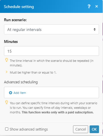

7) Schedule the scenario to run whenever you need it by clicking the watch icon on the Trello module.
8) Finally, don’t forget to slide the ‘Scheduling’ button in the left bottom corner to the ‘on' position to switch your automation on.
