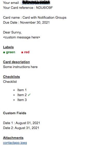

In some way it addresses item 4 because that email would be the card details which you can include checklist (checked and unchecked) and or any attachments, selected CF if you like, labels, description...etc etc.
The email can look like this:
