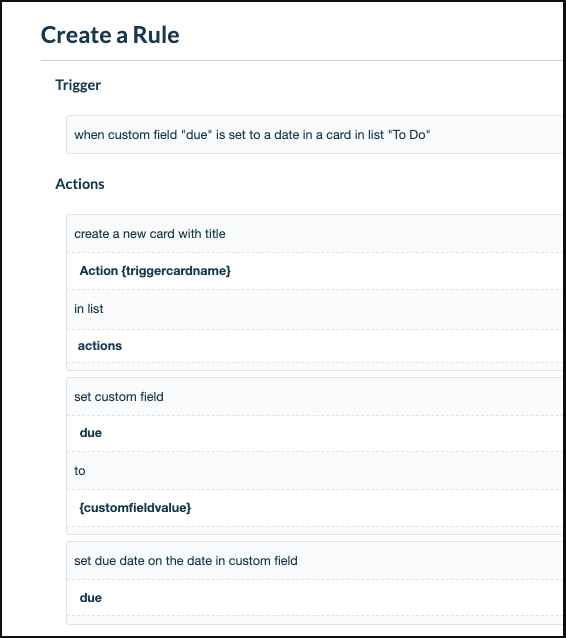

Meanwhile I contacted trello support and got this solution:
I added the condition "card in a list X" so the rule doesn't loop when the custom date is applied on the new card (which would be in a different list).
You can retrieve the value of the custom date via the variable
{customfieldvalue}
as it was used in the trigger.
If the card needs to be created in the same list as the original card though, a loop will be detected and the rule will be stopped (but it should work nonetheless to create the card and set its due date).

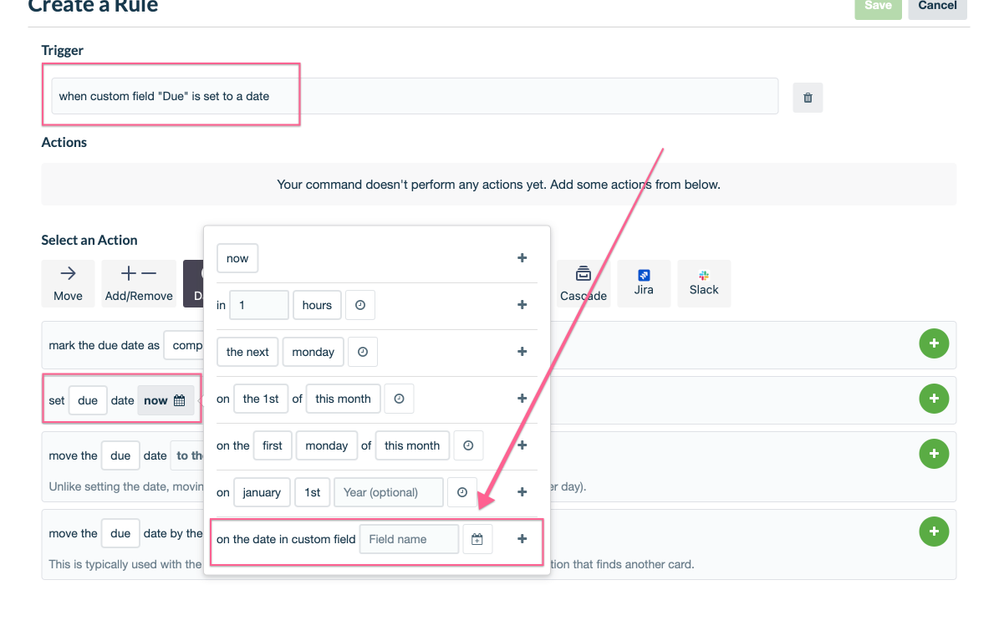

@Antonis Vlachos So what you're looking for is a Due Date trigger that works on a custom field, rather than the Due Date.
That's not currently possible, but you can have several due date commands that take action at different times relative to a due date.
So for example, if the reason you want to do that is that you have a custom field called "Application Date" and 5 days before the Application Date you create a card called "Comlete the Application by {date}", then you have another field called "Review Submission" and 3 days before that is due, create a card called "Review Submission by {date}" then you could achieve the same thing by setting the card due to, say, the finalisation date of the task, then having several Due Date commands that create the required tasks with an offset relative to that one due date.

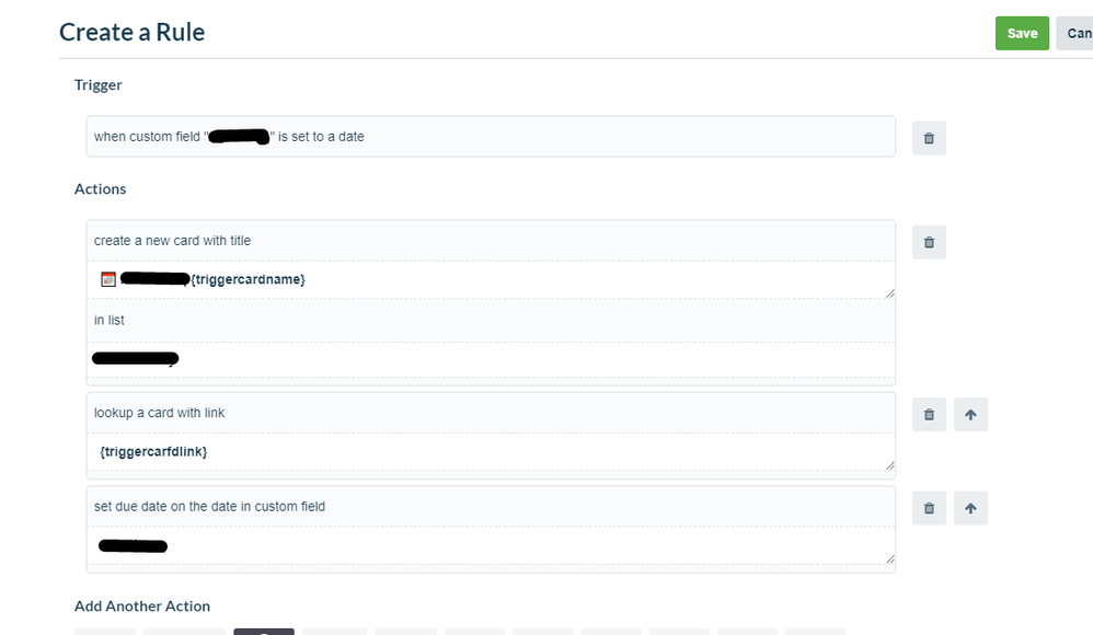

I got to that point my self but...
How to do tell Butler to take the trigger card's field instead of the new card's field? How do you reference that inside the text area you are showing. That's my problem for now. Is there a solution you can provide?
@Antonis Vlachos go to the Cascade tab and choose "look up" instead of "find", and look up card with link {triggercardlink}
All variables references will now go back to the trigger card, but actions will apply to the current subject.

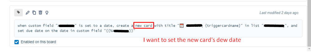

Hello again. Can you please give me an example that for a setting of a date field to one card, a new card is created and has a due date the same with that field you entered in the first card.
What ever i am tring is not working.
@Antonis Vlachos can you show me the command you've created that uses a lookup and I'll see if I can recreate the problem

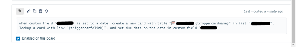

@Antonis Vlachos you have a typo in your variable name, you've typed "{triggercarfdlink}" instead of "{triggercardlink}"
@Iain Dooley You are right, but It's not working even with correct variable. I' ve tried it many times with different combinations.

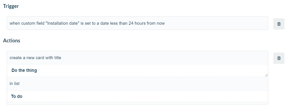

Maybe I'm misinterpreting the question, but I think that trigger would do what you want? For example, I want a card to be created in the "To do" list about 24 hours before a custom field is due.
In your case, you would switch out "hours" with "days", so that way the card is created X days before the custom due date.
You might want a secondary action that says "and link the cards together" so you know what the newly created card relates to, or use a variable in the card title that references the original card.
