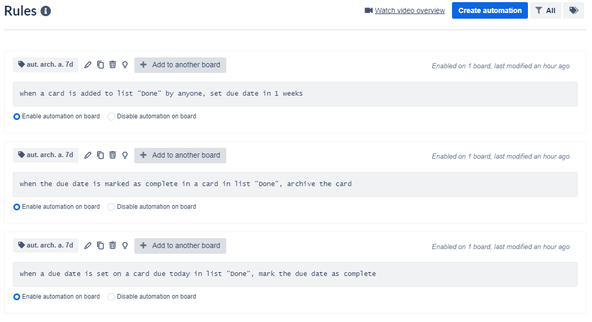

Here is one way to do it (with many customisation options):
What I want:
a List from which the Cards are automatically archived after a specified number of days, after I dragged them in there (or created them there).
Parameters:
[a List where Cards are drawn or created that shall be archived]; [Days after which Cards are to be archived from the List];
I labelled them:
["Done"]; [1 weeks {same as 7 days}] (here you can freely insert your parameters while creating the Rules)
Optional:
of course you can add who the Rule applies to on the Board while creating.
What you need:
  • 3 Rules to rule them all ;)
  • turn on the [Advanced] mode when creating the Rules because these variables are needed
Rules:
  1.  when a card is added to list "Done" [by anyone {this for example is optional to you}], set due date in 1 weeks
  2.  when a due date is set on a card due today in list "Done", mark the due date as complete
  3.  when the due date is marked as complete in a card in list "Done", archive the card
    here it is particularly important to specify the corresponding List, otherwise all Cards on your Board whose due dates are ticked off will be archived ! }
This is how it should look when the Rules have been created in the overview (ignore the order and my label):
Notes:
Be aware that if there was a due date before, this will overwrite it! If it is relevant for your documentation, you should make a note beforehand (or you can surely also write a rule to automate it).
I also use this set of rules in a modified way to move daily or frequent ToDo's from a "Redo" List back to my "TaskBoard" List.
I hope my explanation can help you. Happy automating! :)
Simon Küppers
April 26, 2024
PS:
If you have problems with rule number 2, you can try the following:
2. when a due date less than 1 hours ago is set on a card in list "Done ➔ redo", mark the due date as complete
