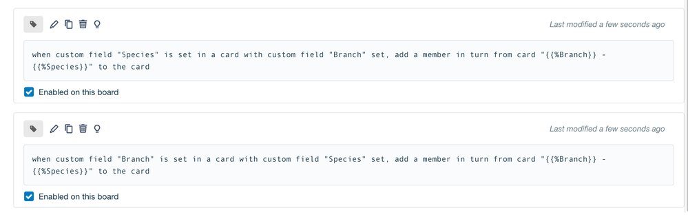

  • Create 2 Butler rules like the following:
With that setup, whenever either of the custom fields is set, and both custom fields are filled out, Butler will look up the card matching both those fields, and assign the relevant coordinator to the card.
The benefit of this is that it's easy to swap out the coordinators, if there's vacations or something. You won't need to go in and update a bunch of Butler rules.
With this setup, you'd also be able to have multiple coordinators for a single combination, and assign cards to them in order, as they come in.

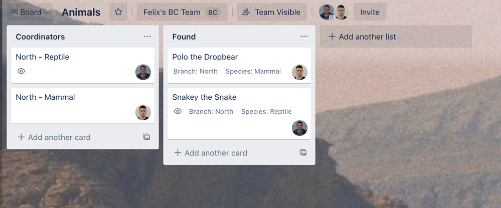

Here's what an example board setup would look like:
