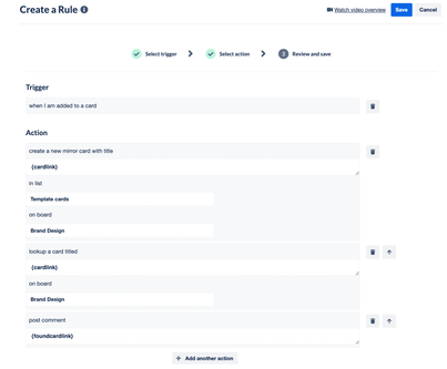

I'm still trying to make the automation work. I don't know if I'm doing something wrong here:

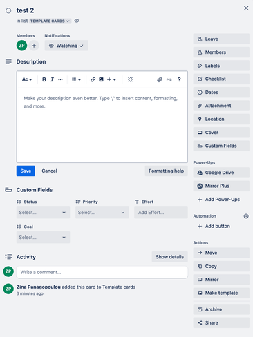

Also, I don't see any link to the mirrored card in the original card otherwise that would solve my problem. Is there a setting I should enable?
DiMaggio Tucci
February 11, 2025
Hello again!
It's because you are creating the mirror card in the same automation, which is switching the card you are focused on.
Here's the updated automation. I tested it and it worked.

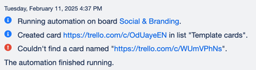

The mirrored card is created but nothing else happens. Here's the activity log:

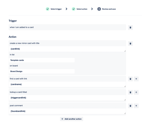

Also I'm attaching the automation rule in case I missed something:
