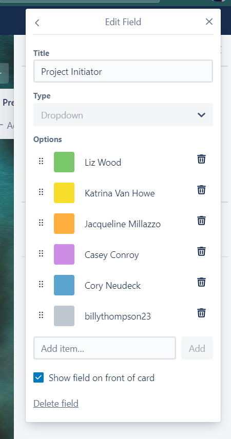

- the item is assigned to a member based on whose name is mentionned in the custom field "Project Initiator"
which means that the custom field is variable. Therefore, instead of creating the rule multiple times (when member A is the project initiatior then assign the item to member A) I wanted to use the variables as mentionned in this post (https://support.atlassian.com/trello/docs/working-with-custom-fields/#custom-field-variables)

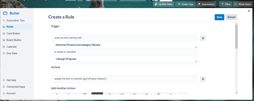

So what I tried to do is create the following Butler rule :
- when item XX is added to checklist YY
assign the item to member @{{%Project Initiator}}
where the project initiator values in the custom field will be the Trello usernames of the members (as I guess there is no other way Trello can match betwwen a full name and a username)
However, when I try to save the rule I get an error saying "CANT_PARSE_COMMAND"
Have you faced a similar problem ? is there something to change in my approach ?

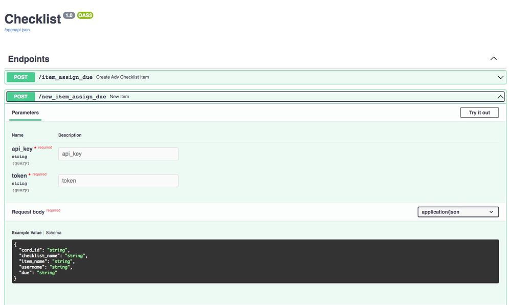

https://github.com/xu2xulim/Superhero/blob/master/Superhero%20on%20deta/Micros/Checklist.md
This is the payload example.
{ "item_name": "An Item on Advanced Checklist", "username": "@any_username", "due": "2022-05-16", "checklist_name": "Advanced Checklist from Zapier", "cardname": "Advanced Checklist from Zapier", "board_id": "5fdd5.........792101e" }
So it depends on your workflow
If your trigger is when you add an item, then the
{ "item_name": "{checklistitemname}", "username": "{{%username}}", "due": "{{%date}}", "checklist_name": "{checklistname}", "cardname": "{cardname}", "board_id": "{boardid}" }

Answering my own question, this was written to create a new card. So it might have to change a bit for your specific use case.

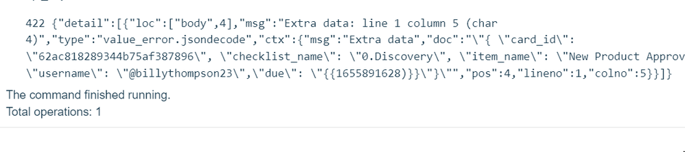

I tried it on a paid plan board and it does not seem to work. I get this error in Butler logs

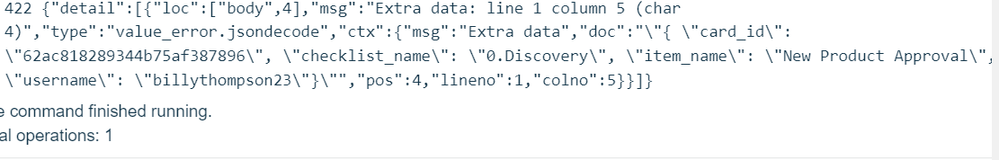

iliaskzz
June 22, 2022
@milynnus I found out I was not including the due date in the request and it's a required field. I added that to the rule but I still get the same 422 error
(I put a standard date in a string format as I have another use case to assign date, the most important thing for the rule is to assign the item to members based on the value of the custom field "Project Initiator")

The due date is just a meaningful date field(text) like 2022-06-22. You should be able to get a string format from your program. If you are using a date cf you should be able do it as well.
Try "due": "{{%Required By}~YYYY-MM-DD}"
