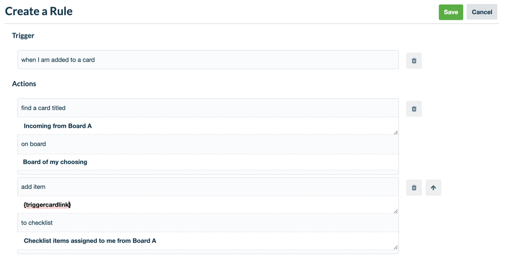

If you have say 10 boards that you have assigned cards and checklist items, you might want to create a card per board in your destination board and have linked item checklists. Then, whenever anyone adds you to a card, the original card will be linked in the checklist on the board of your choosing, likewise when someone adds you to a checklist item.
The rules could look something like this:
You could enable that on any boards you're on, then when you're added to a card it'll put the clickable card link in a checklist {triggercardlink}. You could go further and set it due in 2 days, or make any other amendments that you wanted, so that it would be visual on your board of choice.

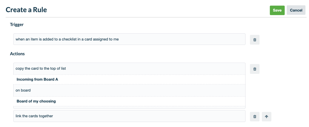

If you really want to have the copy option, this is how to do it:
Then just change the trigger to 'when I am added to a card' - and make sure that both rules (the card and checklist item) are running on all the boards you're a member of, then you'll have all the cards you're on as well as any checklist items you're assigned coming into one board.
