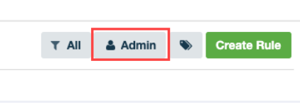

Automation doesn’t keep any hidden cache or history that would affect card names, so there’s nothing to reset there. My best guess is that someone else on your board might have set up an automation that’s affecting this card. If you're an admin, you can check by clicking the Admin button within the Automation menu.
If that doesn’t solve it, I’d suggest reaching out to support through this link.
