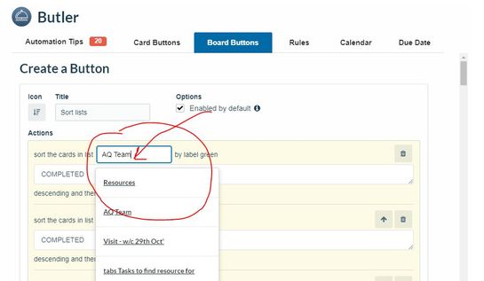

When creating a Board Button in Butler, does anyone know how, when creating the rule, you can select ALL lists at once as opposed to having to add individual sub-rules to the Button for each list on the board?
Also, it appears that there's a max limit of 20 lists for which the command will run..?

The button I'm trying to create is to sort ALL lists on my board by cards with the green "Completed" label descending and then by due date ascending. This would keep "Completed" cards at the bottom of all lists whilst then ordering all other cards by due date.
I have been successful in creating the board button except for I have more than 20 lists on my board and when I run the button command it displays an error message and times out after running the action for only 20 of the lists.
Also, the other point I wanted to make was relating to the UX of adding actions to my board button. I had to add a separate action for each list when creating the board button which was time-consuming. It would be helpful to have an option to select ALL lists when defining the button action. (See screenshot attached).

I understand now, thank you for clarifying. In Butler, you have to specify each list individually to sort. If you are running into timeout errors, I would suggest perhaps breaking your large board into smaller boards for easier management and organization. I will pass on this use case to our team for future improvement.
