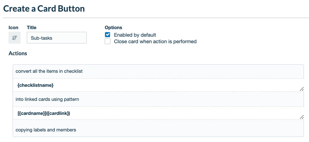

I decided that I wanted to take my checklists to the next level, and for each item on a checklist to be changed to linked cards.
I want to have a card button that would make all the checklist items into linked cards so that I know exactly how much I have to do, rather than just a checklist which doesn't tell me how long things will take.
So, I made a card button that looks like this:
But for some unknown reason, it doesn't do multiple checklists, it only did the bottom checklist on one card, the top one had a task ticked off, so I thought that might have been why. So then I tried it on another card with 5 checklists and nothing ticked off, and it only did the top checklist and not the other 4.
How do I get it to act on all the checklists on the card and not just the one it feels like running on?!

The variable {checklistname} reffers only to the activ checklist which is the last modified. The action
convert all the items in all the checklists
is missing in butler.
So an alternativ to this card button could by a rule like this
when an item starting with "#{*}" is added to a checklist, convert the item to a linked card using pattern "{wildcard1}"
 If you want to convert an item just prefix it with hashtag character for example.
By using pattern, the name of the linked card will be based on item name without hashtag.
And added item without hashtag will not be converted.

According to me, you must to treat checklist one by one. For this you can use a rule like this :
when an item containing "converting" is added to checklist "{*}", remove item "converting", and convert all the items in checklist "{checklistname}" into linked cards
Then,
Just add an technical item (in my use case, named "converting") in a checklist, this will trigger converting rule and remove the technical item.
Repeat this action for each targeted checklist.
@Esme Crutchley , so what I suggest you it is not a card button (it will not work) but a checklist button like.
