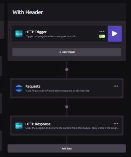

post to url "https://38239.wayscript.io/get" with payload "{\"yourURL\" : \"https://domain.myfreshworks.com/crm/sales/api/contacts/16002233290\"}"

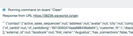

My endpoint has a request module which will provide the header and yourURL  and return a json which will be available to Butler as {httpresponse}
You will notice that there is cardidlong in it. I had put it in the CRM record.
Screen Shot 2021-02-02 at 1.56.48 PM.jpgScreen Shot 2021-02-02 at 1.53.50 PM.jpg

It can be make for general use by have a different payload since the request module can accept variables....for example
{"yourURL" : "https://domain.myfreshworks.com/crm/sales/api/contacts/16002233290", "yourAuth" : "your specific authorization string for Authorization", "yourConType" : "your content type details for Content-Type" }
 I have changed the endpoint to handle the above. See if it works for you. We can talk details later.
