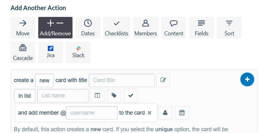

I used the cascade feature, first I use "for each checklist item" and then:
As you see, I have a free text field for the "Card title" where I use {checklistitemname} (that works fine) but the other fields are just dropdowns (with a selection of all board members). I tried to set a guessed variable there but it just ignores it. I hoped somehow it might work with the right variable name, but can't figure it out.
My test now: If I use your variables in the title field (like "x_{newcardduedate}_x" they come back empty (like "x__x"). If I test checklistitemfirstmemberusername and checklistitemcardduedate they are also empty.
So again no solution. A nice feature, but if I loose information in the process it is unfortunately useless for us.
