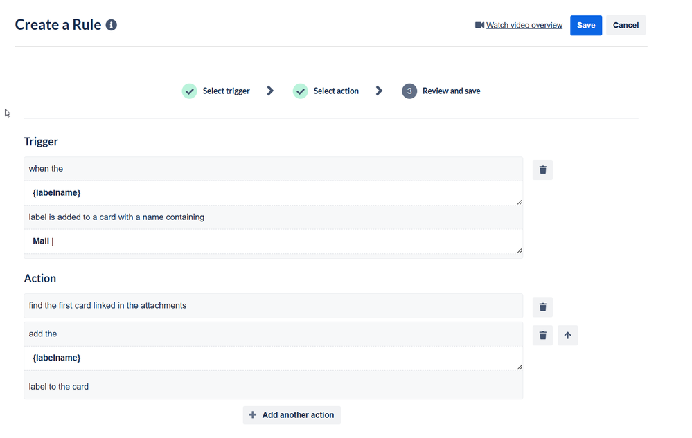

I've created this automation:

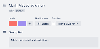

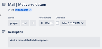

But this does not work properly. What I see is, when I apply a red and purple label on the original:

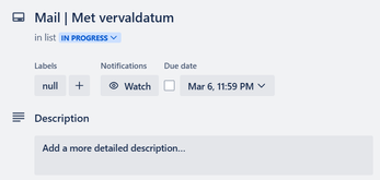

I get one label, called 'null':
I've tried also with {cardcolor} and a combination of the two, but I get the text 'purple' & 'red', not the colored labels.
How can I fix it?

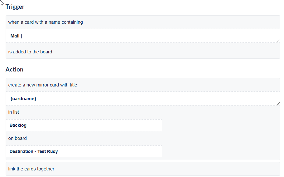

1: See where it says create a new mirror card with title {cardname}? I don't think that will work. It should say create a new mirror card with title {cardlink} instead. Don't worry; you'll still see the original card's name and not it's link when you're viewing the mirror card. But, under the hood, Trello needs it to be named {cardlink} in order to do mirroring.
2: When you are editing the card by hand, you can do it right on the mirror and it will be reflected on the original too, because Trello is actually modifying the original card, not the mirror! However, with automations, if you want to make changes, you must make them on the original card or you will break the mirror. Luckily, this can easily be done. If your automation is currently triggering from a mirrored card, simply use a Cascade Automation to find the original card and modify that instead.

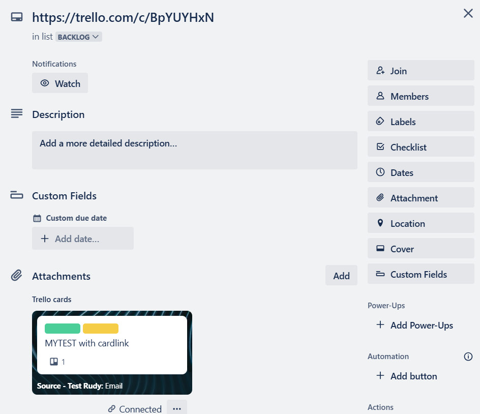

Thanks for your reply. If I create a new mirror card with title {cardlink}, like this
The card on the destination board (the mirror) looks like this:
So it has a link in the title instead of the card title and it does not have the labels.

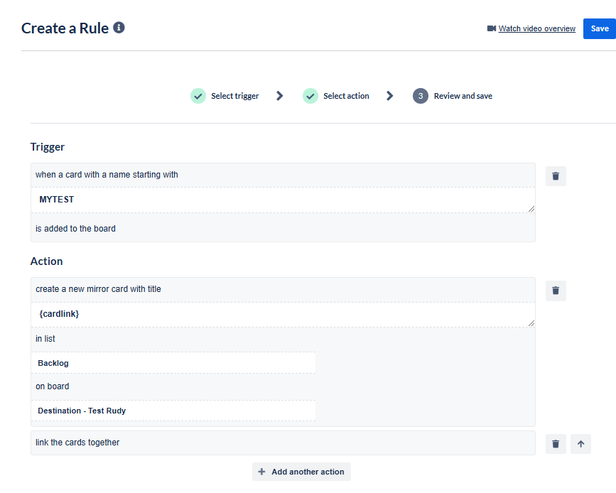

Can you screenshot the entire automation that you're running?
Rudy Holtkamp
March 4, 2025
Sure
