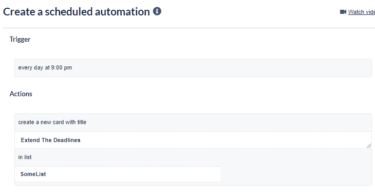

Step 1: Create a new Card that just exists on your board all the time called Deadline Automations, and a new clear label called Extending Deadlines.
Step 2: Create a Scheduled Automation that triggers at 4pm everyday, that merely adds the Extending Deadline label to the card named Deadline Automations.

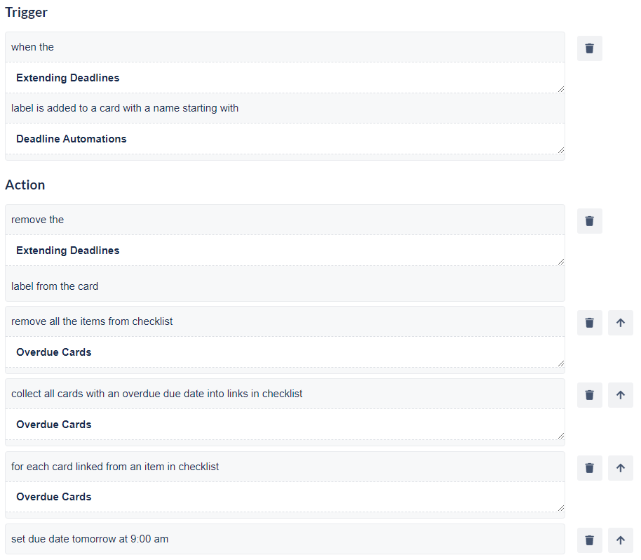

Step 3: Create a regular automation, be careful to use the drops downs / filters to get the details right as below
Helpfully, every day this also gets you a list of all the overdue cards from the day before in a nifty checklist. Of only the latest day though, as the list gets overwritten every day.

Sorry, got busy. Also, my bad. Didn't realize Add Label wasn't available for Scheduled Automations either.
The immediate solution would be to go with Option 2, and use the creation of a card as the trigger instead.
The regular Rule then triggers off of it, and has to do a little shuffle with the card name so that it can archive the previous version of the card without getting confused between two cards being named the sameimage.png
Hopefully that should work. didn't get around to testing it
