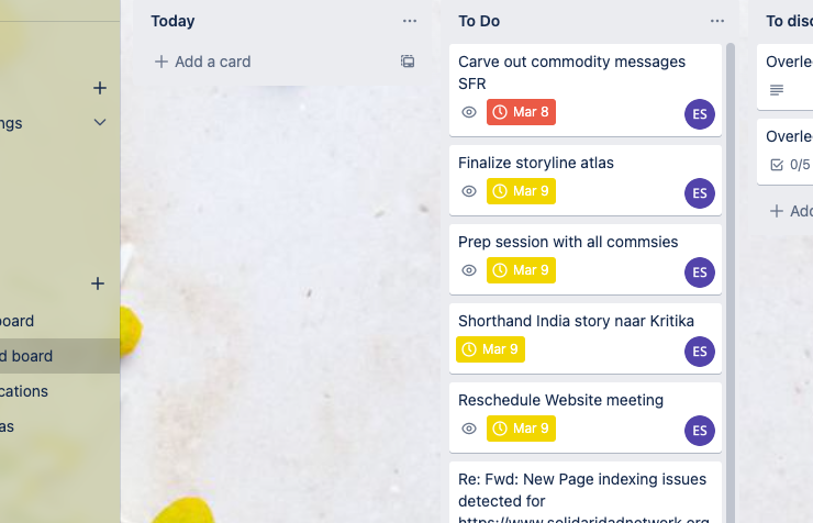

I'm struggling with the automation of Trello. I follow the standard rule:
When a due date less than 1 days from now is set on a card by anyone, move the card to the top of list "Today".
Yet... whatever I try, it doesn't work.
I've waited 48 hours. Set new days after creating the rules, I've triple checked that 'enabled on this board' is checked. What am I overlooking?

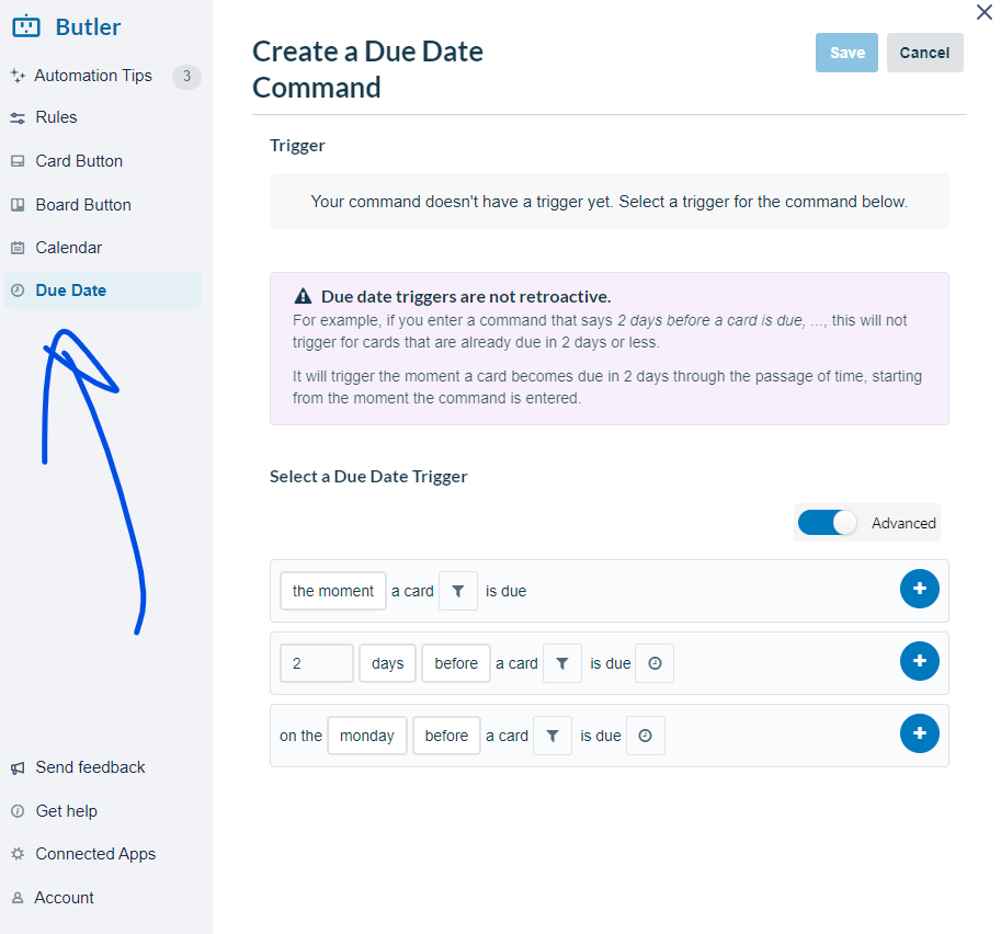

Hi there, this is something that will only trigger at the point you set the due date.
You require Due Date Commands:
Elsa Scholte
March 9, 2023
Yeah! That was it! Superhelpful. Thank you!

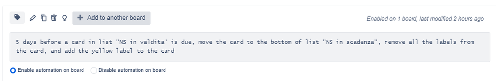

Hi,
same issue, i can get out of the woods.
I set the rule under "automation/due dates" which is not triggered at the time (first i set the rule in a new board, then created the the cards).
Rule calls to move a card from list "valid" to list "close to expiring" 5 days before the due date...no way
I have a premium account
Thanks
