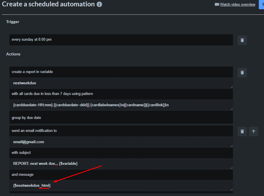

Hello, there. Are there anyone who could help me to troubleshoot? My html custom report doesn't follow my custom pattern.
Before possting I've already read this guide
My process:
I set up simple custom email report of card due less than 7 days
when I do it without html I'm getting correct result in terms of pattern (Time, DayofWeek, Labels, Cardname(link attached)
My current working version:
Then I update msg report variable in order to get html form of report.
To it {$nextweekdue} appending this {$nextweekdue_html}
and get this html result, which ignores my custom patter:
This is my rule:
What am I missing or how I can fix it? I'd like your help, guys)

Hi Dmitry,
Unfortunately, the {$nextweekdue_html} HTML reports have their own standard pattern, and it overwrites any pattern you might set as a parameter to generate the report. So if you need any information that is not displayed in the HTML pattern, you must use the regular text reports {$nextweekdue} in order to be able to customize your own.
You can look at the format from the screenshot shown here:
https://support.atlassian.com/trello/docs/creating-reports-with-butler/#How-to-use-a-pattern-to-customize-your-report
We will take note to update the documentation explaining the _html so it's not confusing.
Hope this helps!
