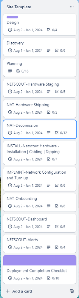

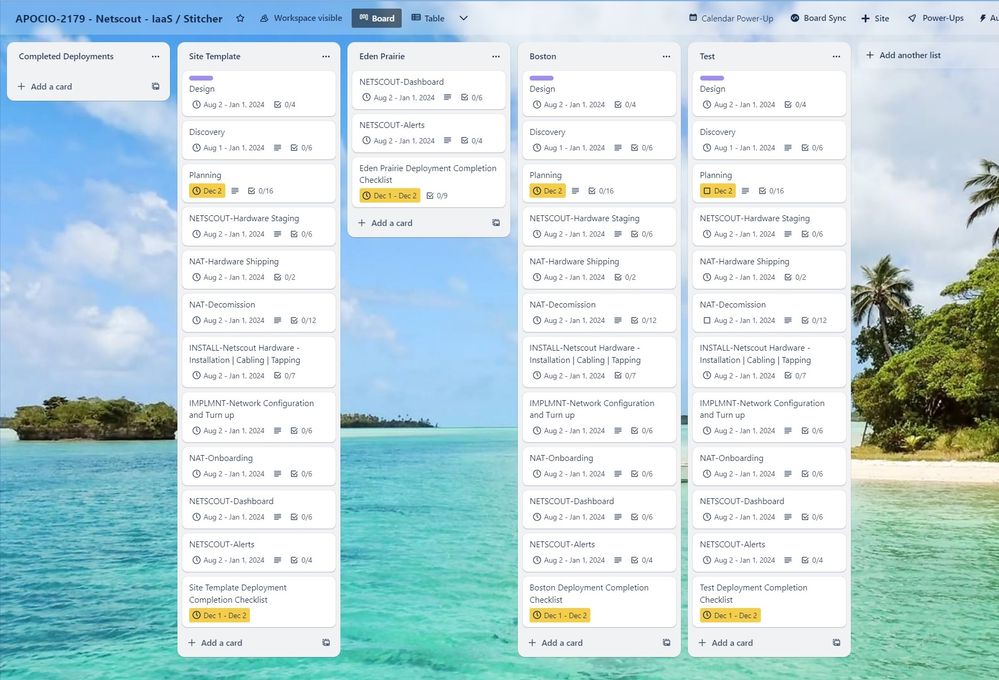

Hi @Hannah Humbert - Simpla Workflows , thank you for responding! So, What I have is a Board setup with a number of lists each containing cards that are set up as a "vertical" workflow. Each card in the list is a step in the workflow and has it's own due date. The last card in the list is essentially going to contain a summary of the completed cards in the list as a checklist. Once the list is fully completed, the summary card with the checklist should be moved to the"Completed" list. Hope this explains it betterexample list.png

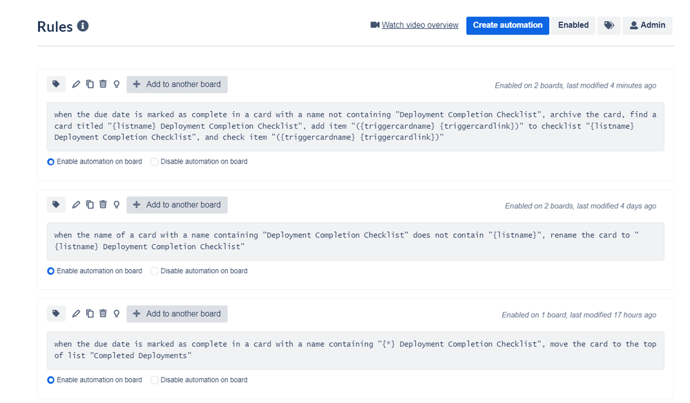

@Hannah Humbert - Simpla Workflows So having some success now but still seeing some things not working as expected.
I've attached a screen clipping of my current enabled automations. With these enabled the issues I am trying to resolve are below
  • For Workflow cards except the Summary card at the bottom when I mark the due date as complete it will add a checklist item to the summary card but it doesn't mark it as a completed checklist item. Would also like these to get archived off the list but when I add that action it only archives the Summary card?
  • Trying to figure out a way to move the Summary cards to the completed list once all items have been completed. Current rule to move it when the due date of the summary card is checked complete doesn't seem to do anything. Board.jpgButler Automation.png

1. It looks like you've added brackets to the name of the checklist item, so you'd need to match that spelling to the last part of your rule. Was the goal to make the checklist item a hyperlink? If so, it should be [{triggercardname}]({triggercardlink})
So it should say: "add item "[{triggercardname}]({triggercardlink})" and then "check item [{triggercardname}]({triggercardlink})".
2. I'm not 100% sure why it's not working for you, but you could instead say "when X checklist is complete, move the card to the list "completed deployments". That way it would just automatically move the card once all cards are complete and eliminate the extra step of marking the due date as complete on that card.

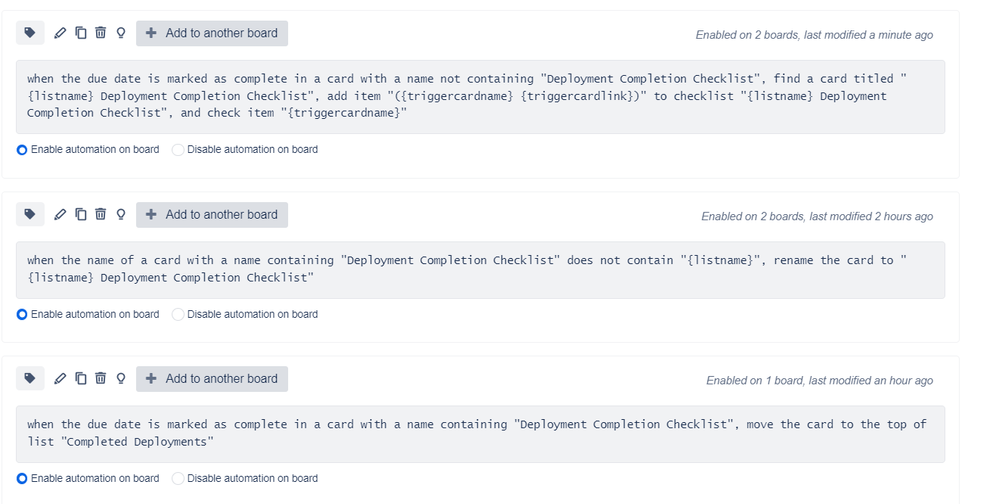

richard.whelan
December 5, 2023
Hi Hannah, I was able to resolve all the issues and the board is now working as intended! I've attached a screenshot of the working automations if anyone is interested in using them. Thanks for your assistance! Final.png
December 5, 2023
Ah, nice! Glad that's working for you. Good idea to use a wildcard in your last rule.
