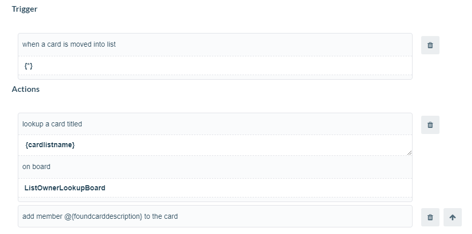

So the simplest solution was already mentioned, where you have a separate rule for each list+member combo.
This solution uses wildcards, lookup boards, and the {found} variable prefix.
First step is to make a lookup board and give it a proper name. Populate it with a separate card for each List you want it triggering on. Each card must have the exact same name as the List, and the description must have the plain text username of the person responsible for that List (and nothing else, not even additional spaces).
Then add the following rule to your board (replace ListOwnerLookupBoard with whatever you named your lookup board). Make sure its a Lookup command and not a Find command:
If these lists exist on multiple boards, you can "+Add To Another Board" the rule. Any changes you make to the rule and you will be prompted on save to Apply to Other Boards.
That should work.
For an explanation of what it does: When a card is moved in to any list, it will try to look up a card with that list name on your lookup board. Then attach the username it finds in the description to the original triggering card.
If you moved it to a list without a matching card, the command will safely self-terminate, but will send you an annoying notification that the command failed. Last I checked, no way to turn off that notification sadly.
((Note: You may tinker to try and find a better solution than using the description. But for whatever reason the {found} prefix doesn't work with Card Member variables, even though it explicitly but incorrectly states that it does. And last I checked, you can't directly reference another card's custom fields, not without doing some weird shenanigans anyways.))
((Extra step: to bypass the awkwardness of having to type the username of each person and potentially fat-fingering it. You could set up another rule on the lookup board, such that when you attach a member to a card, it automatically sets the description to {cardfirstmemberusername}. And just make sure to always remove a member before you add a new one.))
