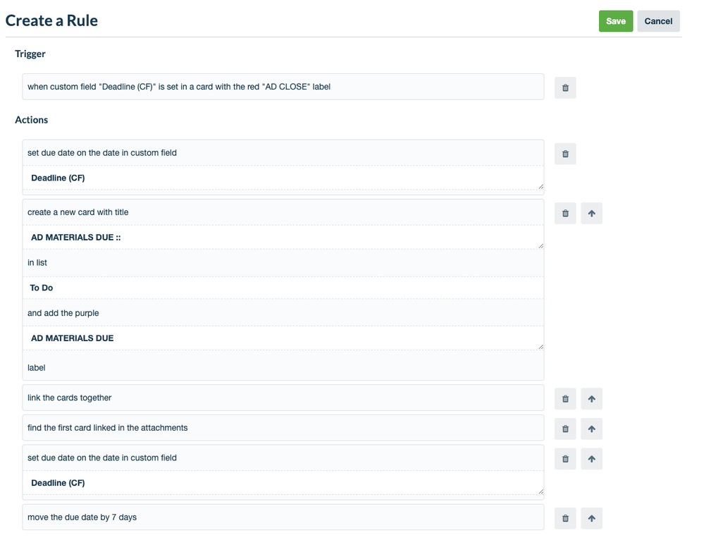

I'm trying to create a rule w/Butler to automate card creation with due dates, but, the new card generated never copies over the due date. I'd like the due date to copy over, then add 7 days, which would create a new due date for the new "Linked Card."
When I run the rule, it goes as far as creating the card, adding the "Link" to the original card, but it never carries over the due date. Here's a screenshot of the rule:
I've also tried to have the rule refer back to "find the first card linked in the attachments" before setting the due date:

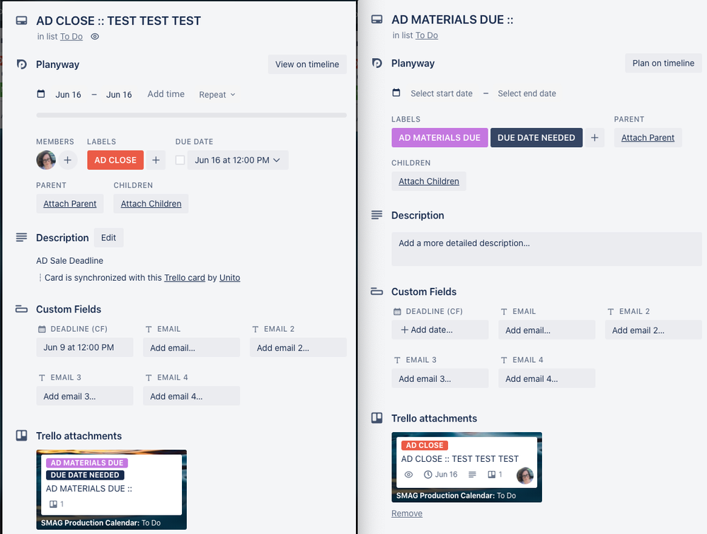

Here's a screenshot of the two cards I end up with, the 7 days have been added to the original card's Trello Due Date:

@Virginia Le the problem is that when you "find" a card, you make that the subject of any subsequent commands. If instead you use "look up", you will be able to access the variables from the found card but you can use those to set values on the card you're working on.
The only rub is that you can't access custom field variables on looked up cards, so you will need to add a step which is to see a custom field on the subject card to the variable {foundcardduedate} and then set the date to the value in the custom field plus 7 days.

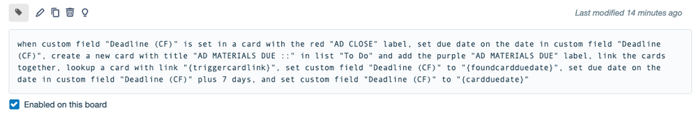

The following rule is working now, adding the 7 days to the new card.

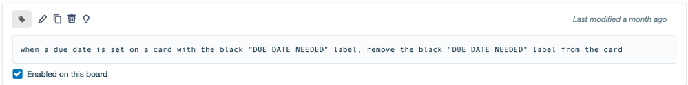

But another rule is no longer running on the new card. Let me explain, I have a DUE DATE NEEDED label routine added to all new cards, then removed when a due date is added to the card. (Let's call this Rule 2.) (Let's call the rule we have been discussing originally Rule 1.)
Here is Rule 2:

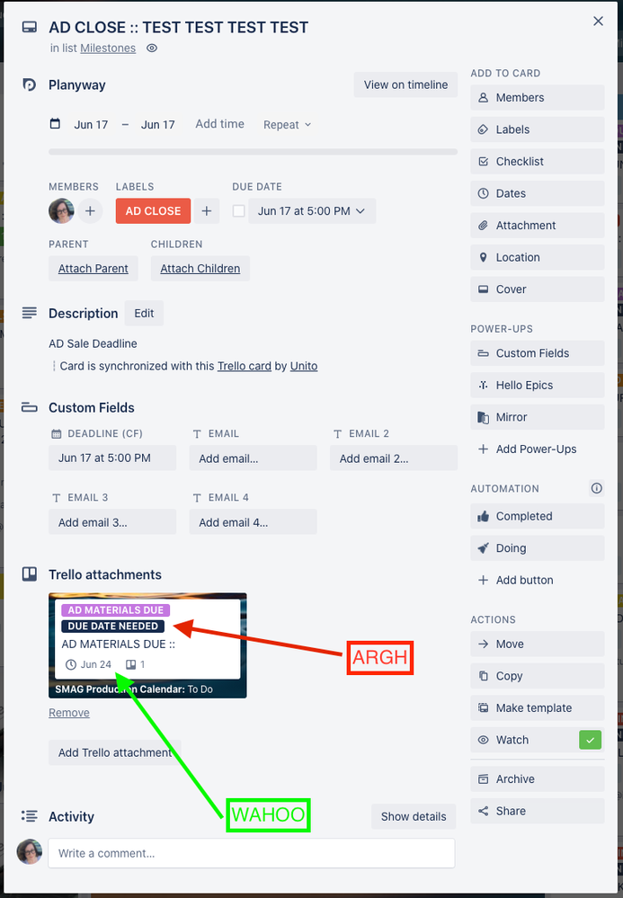

When the Rule 1 runs, creating the new card w/the 7 days added, and applied to the card's due date, the DUE DATE NEEDED label should be removed by Rule 2. But, it does not remove the label. So, I experimented several label removal additions to Rule 1, but that didn't work either.
This is how the cards end up:

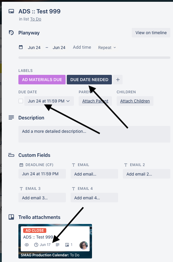

Here's the card generated after Rule 1 runs, Due Date Needed Label stays, even though due date is set:

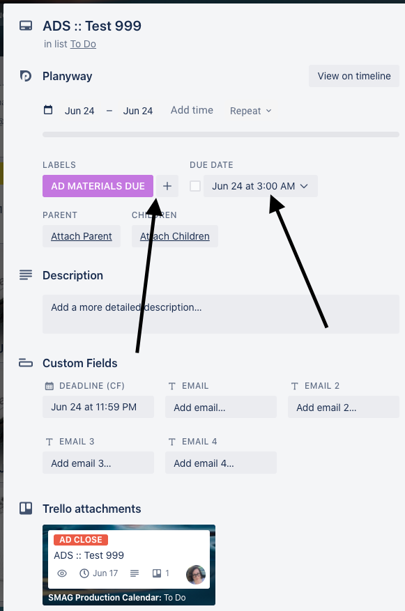

Here's the card after I tweak the time in the due date, Rule 2 recognizes the due date and removes the label:
