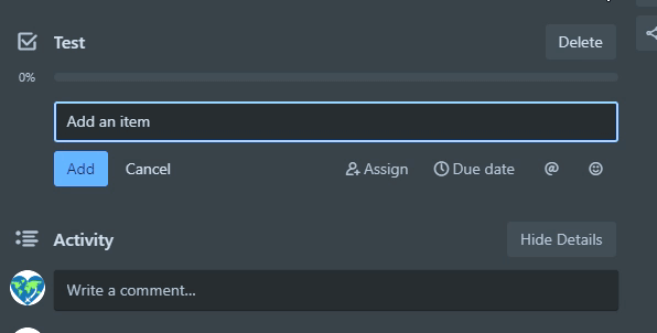

Hi there folks - looking for an automation to automate the adding of due dates / times to my checklist items, similar to what I've set up in my cards across my boards. Have been scouring several boards but found no solution to this.
