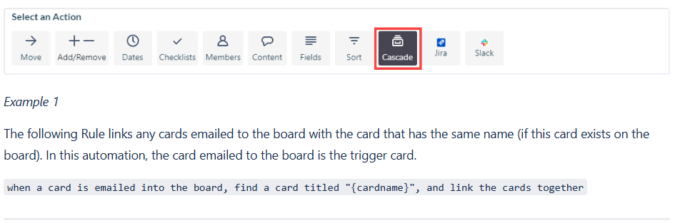

Kalyn Adams
February 4, 2025
Screenshot 2025-02-04 103834.pngI ended up using this code but had to change "cardname" to "cardlink"  and it worked!! But you were right I had to do it from the source card page.  Thanks again for your help!
DiMaggio Tucci
February 4, 2025
@Kalyn Adams
Yes! with name {cardlink} if from the original card, with link {cardname} on board [YOURBOARDHERE] if from the mirror card.
