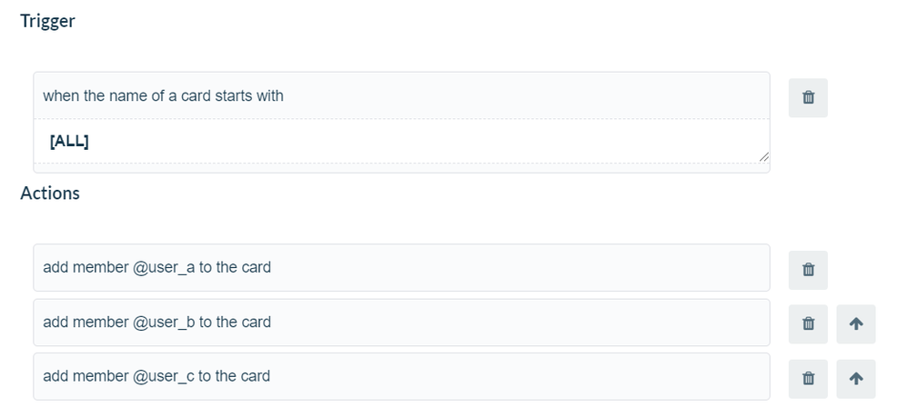

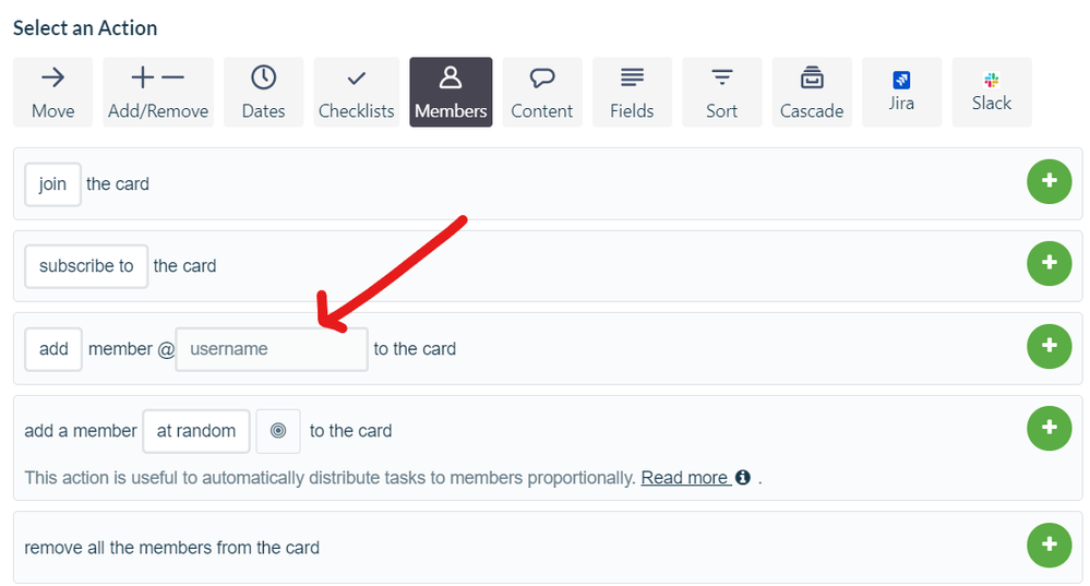

@Luke Huffstutter Butler would be the way to go. You can create a card button that has the action to add multiple members to a card. Alternatively, you could create a butler rule so that when a certain thing happens on a card, it adds all members (e.g. when a title contains a specific phrase, when a specific label is added, when a card is added to a specific list, etc.)
However, I couldn't see an action around the lines of "add all board members". Maybe there's a better way, but it looks like you would have to add the action multiple times for each board member, and as new members get added to the board, you would  have to update the automation to include that new member:
